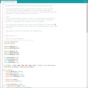

Step 3: Configure the Program
Download the attached .ino file and open it.
Here you should note 2 key variables.
- UPPER_TH
- mac[ ]
UPPER_TH is the threshold which decides when the plant gets water. The higher the threshold the dryer the soil. the range goes from 0 to 1023 because of the A/D converter build into the Arduino. This sketch where build for a chiliplant, which does not need to much water. Thus, you might want to lower the threshold according to your plants need.
mac[ ] This is what your MAC adresse is for your Ethernet shield. You should change it to what i printed onto your board. If your board does not have one, simply make one up, as long it is not the same as some other device on you LAN.
Feel free to modify other parts of the program, like the MAX_DEVIATION, WATER_SECor other parts if needed.

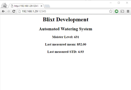

- Now go to your browser and type http://"Your Reserved IP":"Port" (e.g. http://192.168.1.50:12345). Now you should see the webserver from the Arduino. Now find you WAN IP-adresse (can be done here) and paste that in, instead of your local IP-adresse. Note: Test this on a device that is not connected to your LAN.
