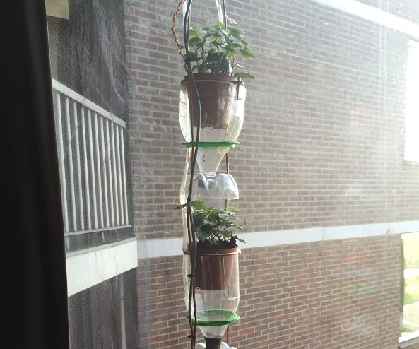

Hi there! My friend and I made a cool window farm that waters itself based on the moisture values that the moisture sensors pick up. In order to make this window farm, you’ll need to have access to a 3d printer and a laser cutter to make the neccesary frames.

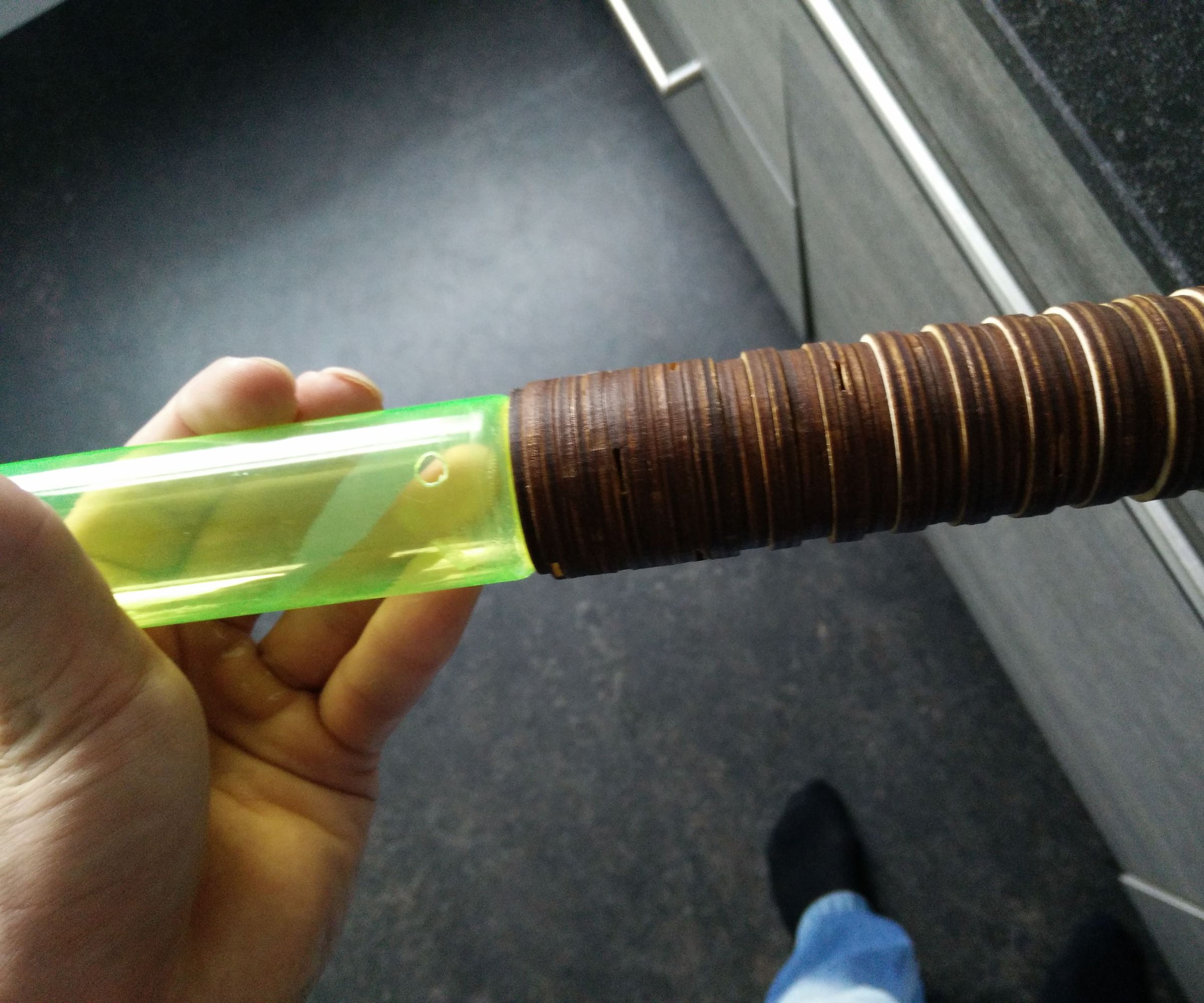

We made small rings of 3mm triplex wood for the Windowfarm. We used a lasercutter to cut out the wooden from the triplex wood. We used the wooden rings to hold the plants inside the Windowfarm. You need 2 wooden rings to make our Windowfarm.
Notice: The wooden hammocks are only used to hold a certain type op flower pot in place and to prevent it from falling further inside the Coke bottle. Whether or not you’ll need to use the wooden hammock depends on the size of your flower pot. There’s a possibility that you won’t need them at all.
We also made 3D printed bottle hammocks. We used these hammocks to hold the Windowfarm together. We downloaded the file from Thingiverse(URL at the bottom) and printed the hammocks with MakerBot. You need 4 hammocks to make the our Windowfarm.

After you’ve cut all the holes in the bottles we can now begin to attach the frames to the bottles. The easiest way to do this is by using hot glue. Each bottle needs a 3D printed frame attached to the neck of the bottle as you can see below.

When you’ve done all this your Window Farm should look something like this, but without all the wires and plants ofcourse. :)

The base of the Window Farm is complete and now its time to add the flowers. If you made the holes big enough, you should be able to put the flower pots inside the bottles with relative ease.
This is an example for the middle bottle on how the wooden hammocks will prevent the flower pot from falling in. We removed one the circle sticking out from the frame because it had no function in the middle bottle. The other circle needs to stick out of the Coke bottle, and you’ll need to cut a hole in the bottle in order to stick it through. So that we can use the circle for the airs pump’s tube later on.
The upper plant is a little easier to place in in the Window Farm. Simply put the flower pot inside the wooden hammock (in case needed) and then place it in the upper Coke bottle so that the two rings sticking out are preventing the plant from falling inside the bottle.
