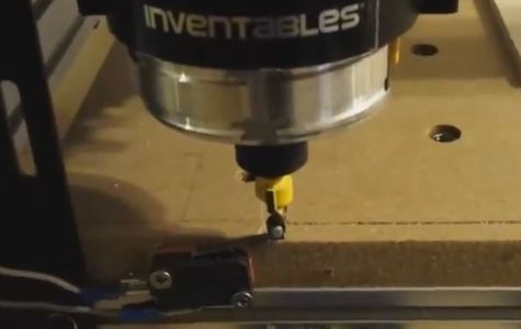

Step 1: Installing the Switch.
For this process I used a micro-switch.
Locate and mount your micro-switch directly under your homing position of your spindle.
So if you move the z-axis down it will hit the switch perfectly.
Mine is mounted like the picture that on the side of the board just above the aluminum.
I show another option for mounting, just in case you are homing to the back of your machine.

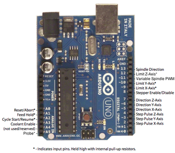

Step 2: Connecting / Wiring Up the Switch.
On Grbl v0.9 or later they have a probe input on A5.
Connect GND to the Common location on the switch.
Connect A5 to the N.O. connection on the switch.
Thats all for the wiring.

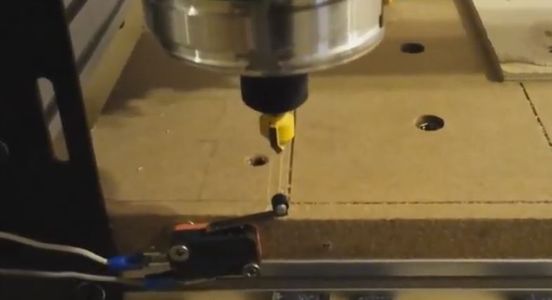

Step 3: Getting Your Switch Point Height Difference.
I use paper under the tool method.
1. Load a thin tool into the spindle.
2. Home your machine using $H or (Home) on your sender.
3. Move the spindle down to just touch the switch
4. be sure the tool is centered on the switch, if not then adjust the switch position.
5. Set the Z-Axis to zero, (G92 Z0) or zero button on sender.
6. Set the feed rate very slow (F10). (About 10 inches per min or 250 mm per min.)
7. Using the G38.2 Z-(??) G-code - Example. (G38.2 Z-6.25) This will move the bit down until the switch activated.
8. Set your Z-Axis to zero again. (G92 Z0)
9. Using your sender or controller, move the machine over your waist board in the cutting area.
10. Set the height of the tool so a piece of paper is just touching the tool. (We can adjust for +/- later)
11. Take note of the height of Z on your sender. (Mine is -6.5mm)
12. Now you know the offset of the switch point to your table top.
13. You can call (G92 Z[your offset inverted]) example (G92 Z2.5)
Keep this offset number we will use it in the next step.

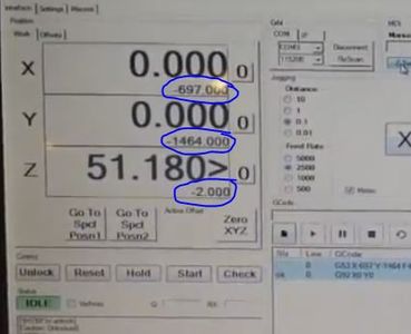

Step 5: Machine Location Movements.
As a standard, when you home your machine $H it will not mess with the axis zero locations.
So the X0 and Y0 should stay the same after homing the machine.
That said, we can use this time to send the machine to a position we always use for X0, Y0.
Look at the picture and in the blue circles, this is the machine position or location for X,Y,Z.
The main reason for this is that after the machine homes,it sets the machine location to zero at the home spot.
So if we call a G53 to move the machine to a machine location, we then can duplicate this after every homing or tool change.
So the last 2 lines of G-code below returns my machine to a machine position of X-710 Y-1466 and then sets that position to x0 y0 by using G92 X0 Y0.
