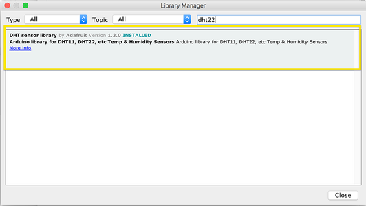

If you dont calibrate the SGP30 it going to try to go back to 400ppm after a couple of minutes.
my tip is to first add the DHT22 sensor then take the "baseline value" shown in the picture abowe.
See the adafruit.pdf for more information about how to calibrate the CO2-sensor
Step 3: ADD a DHT22 TO GET MORE PRECISE METUREMENT ?
Get a more accurate result: USE A DHT22
Add one Temperature and Humiditysensor to get more accurate Co2 Data !
