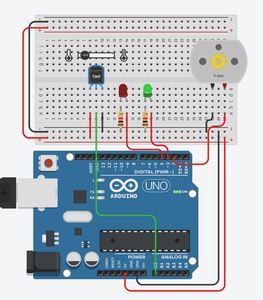

I have made a Automatic AC with temperature sensor, and this project I have made it if the temperature if is getting warmer the motor will turn on and it gives a indication of led that the place is warm or getting hot. And when the the place is getting cold and it gives a green light an turns off the motor.

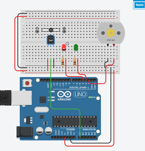

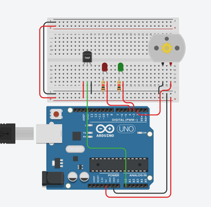

Step 2: Step 1: Circuit Diagram
  • I have used temperature sensor and connected it to the Arduino at GND, 5v and data pin using breadboard.
  • I have also used LED's green and red and connected it to the resistors of 1k(ohms) to control the current of led.
  • I have also added motor and connected it to Arduino using breadboard.

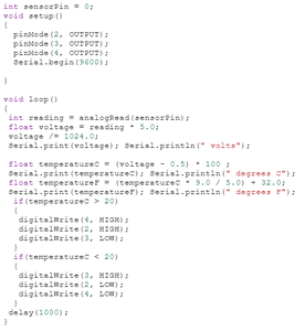

Step 3: Step 2: Programming
First in void setup I have wrote the pin no's of the electronics and I wrote serial no. In void loop I have written the code for temperature sensor and then wrote the motor and led.
