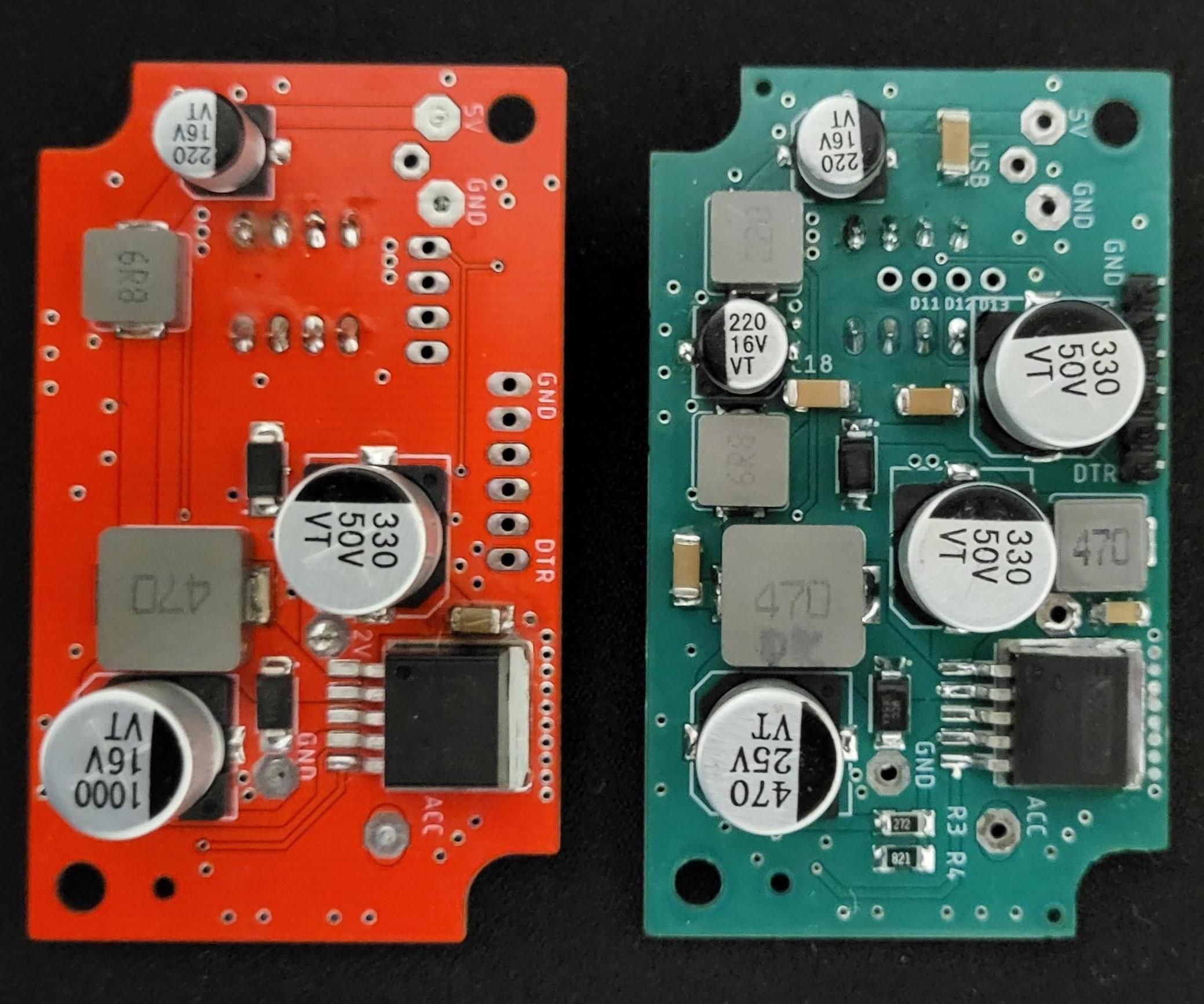

This automatic antenna switch consists of two devices. Band decoder and antenna switch.
The band decoder identifies the band on which the transceiver operates and the antenna switch ensures the antenna switching.
I described the band decoder in this article: Kenwood-TS-890-Band-Decoder. Here I will focus more on the the antenna switch.
New version of my band decoder PCB has possibility to add SN7407 and it means to create ICOM CI-V interface. I only wait for my new IC-7300MK2 (hope it will come in January) to test ICOM code.
