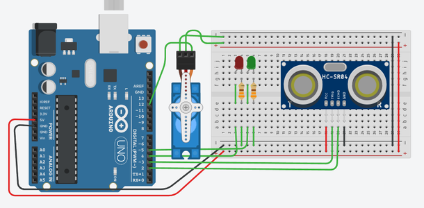

Step 1: Circuit Diagram and Schematic
On the wiring end of the project, there are three main components which are the ultrasonic sensor, the two LEDs and the servo motor. The ultrasonic sensor has four pins.
The two pins called VCC and GND are connected to the positive and negative terminals respectively while pins trig and echo are connected to pins 3 and 2 on the arduino respectively.
For the connection of the servo motor, there are 3 components which are ground, power and signal. The ground is ground and power is connected in the same way the VCC and GND are in the ultrasonic sensor which is just the positive and negative terminals, and the signal pin is connected to pin 12.
The final components of the circuit are the two LEDs. The red LED is connected to pin 4 and this turns on when the drawbridge is down, while the green LED is connected to pin 5 and is turned on when the drawbridge is up.

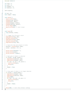

Attached is a photo of the entire code.
Setting up Variables:
int trig = 3;
int echo = 2;
int ledopen = 5;
int ledclose = 4;
Servo myservo;
int pos = 0;
bool isOpen = false;
Variables trig and echo are set up to 3 and 2 so later on when we want to use digitalWrite to turn on and off the functions for the ultrasonic sensor, the code is easier to understand. Same thing with variables ledopen and ledclose. ledopen is connected to pin 5 and ledclose is connected to pin 4 so it is easier to use the named variables when calling upon those pins.
Servo myservo is just declaring that there is a servo motor being used and that it is now named myservo which means I can use that similarly to a variable. The variable pos is setup so that later on in the code, I can set the degrees rotation of the servo motor to be 0.
The final part is bool isOpen = false and this is a boolean flag which declares if something is true or false. This will be used in the code to know if the bridge is open or it is closed.
Void Setup:
void setup() {
myservo.attach(12);
pinMode(trig, OUTPUT);
pinMode(echo, INPUT);
pinMode(ledopen, OUTPUT);
pinMode(ledclose, OUTPUT);
Serial.begin(9600);
myservo.write(0); // start closed
myservo.attach(12) makes it so that it is known that the servo motor is connected to pin 12.
All the pinMode code declares whether the variables (all pins that were given a name in the setting up variables portion) is an OUTPUT or an INPUT. When a pin is set as INPUT, it's ready to receive signals from external sources while a pin set as OUTPUT is ready to give signals to external devices.
Serial.begin(9600) just initiates the serial monitor. Although the serial monitor is not directly needed for this project, I would recommend using it to make sure if you have problems in your code, the issue would not be with the ultrasonic sensor.
Void Loop:
void loop() {
long duration, inches;
// Trigger the ultrasonic sensor
digitalWrite(trig, LOW);
delayMicroseconds(2);
digitalWrite(trig, HIGH);
delayMicroseconds(10);
// Read echo time and convert to inches
duration = pulseIn(echo, HIGH);
inches = duration / 74 / 2;
// print out the distance between ultrasonic sensor and object
Serial.print("Distance: ");
Serial.print(inches);
Serial.println(" inches");
// Open gate if object is detected
if (inches < 10 && !isOpen) {
digitalWrite(ledclose, LOW);
digitalWrite(ledopen, HIGH);
for (pos = 0; pos <= 65; pos++) {
myservo.write(pos);
delay(15);
isOpen = true;
// Close gate if object is no longer detected
if (inches >= 10 && isOpen) {
digitalWrite(ledopen, LOW);
digitalWrite(ledclose, HIGH);
delay(1000);
for (pos = 65; pos >= 0; pos--) {
myservo.write(pos);
delay(15);
isOpen = false;
delay(100); // small delay between readings

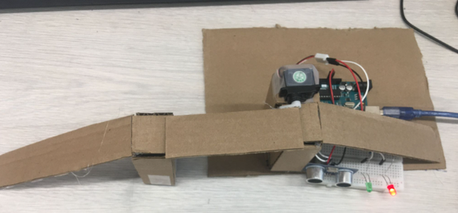

Step 3: Build the Bridge!
Only cardboard and glue/tape required to build the bridge. First, build two pillars from cardboard rectangles and connect a ramp to both of them. I then made a third pillar about 3mm shorter than the other two and taped the servo motor down to it. Then just glue a piece of cardboard to the servo motor. Make sure to place the ultrasonic sensor where it can sense the object!
You're Done!
Click on me for Video of Finished Product!
