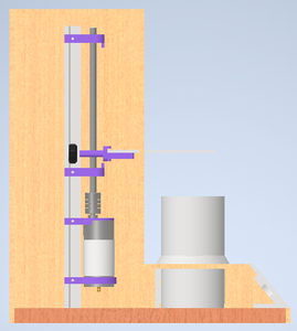

Step 1: Linear Rail
All components are mounted on a wooden board measuring 197 x 325 x 18 mm, which allows for easy attachment using screws.

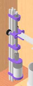

A V-slot aluminum profile is the base for securing the linear actuator. This profile is highly versatile, offering various options for attaching components. It is fixed to the wooden board using brackets, which are screwed to the wooden board and secured to the V-slot profile with Tee nuts and screws. One main support bracket is mounted at the back, while three additional side brackets ensure stable attachment in a single location.

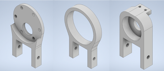

The profile serves as the mounting point for the motor and the trapezoidal screw, which together form the linear actuator. The motor is secured using custom 3D-printed parts, which are attached to the profile with V-slot nuts and M3 screws, and to the motor using M3 screws. The trapezoidal screw is also mounted using 3D-printed parts. Bearings with an 8 mm inner diameter are inserted into these parts to hold the screw in place. End limit switches are attached to these printed parts.
The connection between the motor and the trapezoidal screw is achieved with a flexible shaft coupling. This coupling ensures torque transfer while compensating for minor misalignments, which extends the motor's lifespan compared to a rigid coupling.
Attached to the trapezoidal screw supports is a carriage with the bottle opener. The carriage is firmly secured to the trapezoidal nut using screws. To enable smooth linear movement, V-slot wheels are attached to the sides with printed spacer posts and M5 screws. These wheels minimize friction and fit into the grooves of the V-slot profile. Finally, a hinge is attached to the carriage, and the bottle opener is attached to the other end of the hinge.

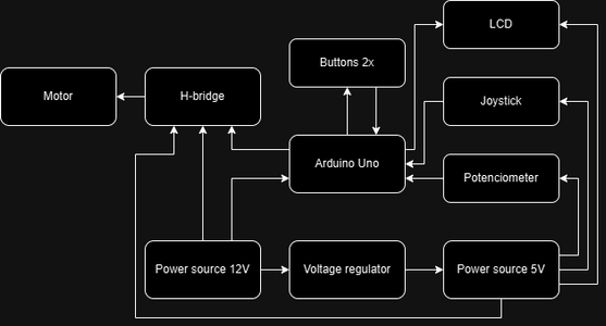

Step 3: PCB
The Automatic Party Bottle Opener required a power distribution system for 12 V, 5 V, and GND (ground). To meet this need, a custom PCB was created.
The PCB receives 12 V and GND from a 12 V / 3 A power adapter, which features a standard male DC connector. This connector plugs into a female DC socket, which outputs two wires (12 V and GND) to the PCB. The PCB distributes 12 V and GND using terminal blocks and regulates the 12 V down to 5 V for further distribution.
The PCB includes six terminals for 12 V, nine terminals for 5 V, and fifteen terminals for GND. Of these, three 12 V terminals, six 5 V terminals, and eleven GND terminals are currently in use. The remaining unused terminals provide flexibility for future upgrades or modifications to the Automatic Party Bottle Opener.
Additionally, the PCB is equipped with an indicator LED and a resistor to signal when power is being supplied to the board. Voltage regulation is handled by an L7805CV voltage regulator, which ensures a stable 5 V output.
