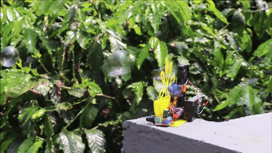

Step 4: Setting Up Bubble Maker
The circuit here is simple, we have 2 different set of circuit one is for the speed control of servo that control the bubble maker wheel
Other is the dc fan that is directly connected to battery and runs at full speed
Using screws connect this bubble wheel to the servo shaft and make sure that the bubble wheel rotates along with rotation of servo shaft
Connect the wheel to servo and the servo terminals are connected to the speed controller and the power pin from controllers are connected to the battery source note that here i will be using 3.7v battery source
When the knob is turned to clockwise the speed of servo should increase and in the opposite direction when knob is turned servo should slow down
After this test is complete, I will attach the servo the frame to do this i will add a small piece of 3d printed piece to adjust the height of servo
Here i suggest you to use superglue instead of hot glue and press firmly to join the 2 parts and get the most of glue
At this point we are done with half of the job now we can work on the air blower part

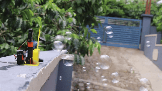

Step 6: Using the Bubble Blower
Using this is a simple task all you have to do is fill the tank with bubble liquid
Dont know how to make bubble liquid? use 100ml of water and now pour 20 to 25ml of dish wash liquid and give it a gentle mix and now pour this to the tank
Start the blower fan first and then you can increase the speed of servo using the PWM speed controller
When you start seeing the bubbles and if you think you want more and more gently increase the speed of servo using the speed controller this will make the servo spin faster and then the bubble blower starts to make more and more bubbles
Avoid using this device in too much windy places even if you do make sure the direction of air blow is same as the air blower direction this will increase the speed even more and give good results
