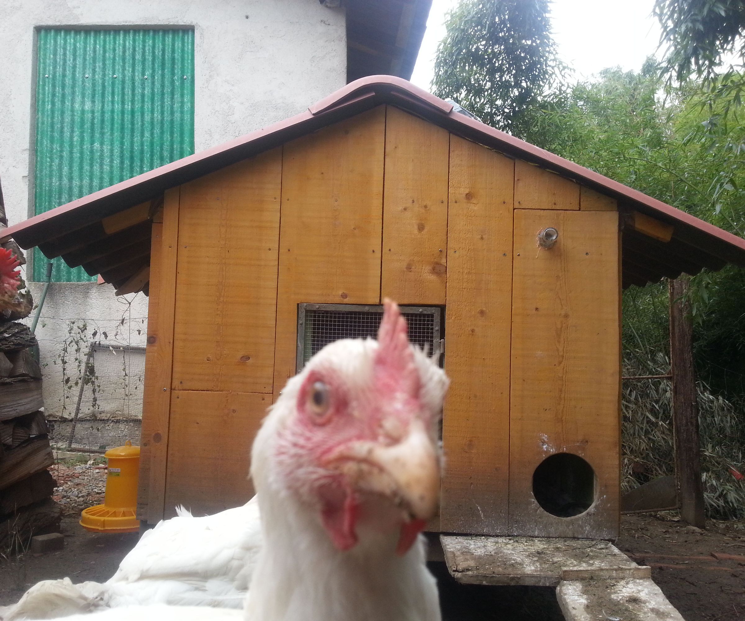

Step 1: Assembly
Cut the M5 rod to arround 270mm. Tigheten the screws around the bearing and place it inside the bearing holder, tightening the screw on the holder. Place two screws where chain should start winding and insert the chain. Set up the right bearing holder with a bearing and two nuts. Add two L profiles to the stepper motor, add a coupler and put it in the rod, then tighten the coupler.
Make a hole in the polycarbonate and tighten the other end of the chain with a screw and an electrical connector to secure the chain. Maybe add some rubber or hot glue to prevent unscrewing.
Step 2: Wooden Board
Cut a bigger hole(200mm) at the bottom and smaller one(50mm) at 700mm from the bottom of the board for photocell. Hotglue a transparent lid in the hole; penetrating outside to get more light. Screw in the sliding profile straight. Screw in bearing holders
