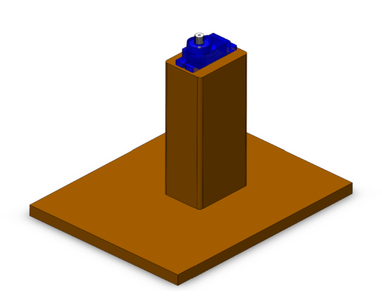

Step 2: Base
For the stem, cut a roughly 4” x 3” piece of foam board, and fold it around your positional servo as seen below. Proceed to glue the folded structure along the open edge, and glue the servo into place at the top.
Glue the stem to the center of the baseplate, being sure to route your servo wire between the baseplate and stem

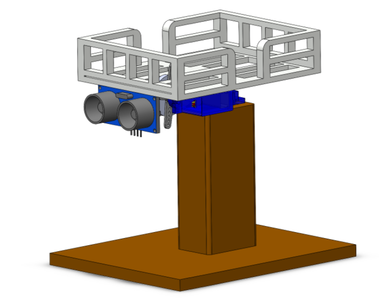

Step 4: Card Cage 2
Glue the servo, a servo horn, and the ultrasonic sensor to the bottom of the card cage as seen below. Take caution to ensure you are gluing your servo and ultrasonic sensor on the side of the card cage that has the slit.
Step 5: Mechanical Completion
Because your card cage already has the servo horn glued on, and the base has the servo, simply place the card cage on top of the spline of the servo on the base.
