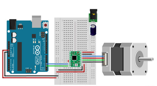

Step 4: Make Circuit
**Image from Arduino Forums**
Along with this image I wired the PIR sensor to pin 13

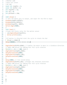

Step 6: Code
I then wrote the code for the entire system. This is a very simple program that when motion is sensed, a timer of 5 minutes starts (to ensure the cat is not in the litter pod) then the motor rotates clockwise to rotate the pod. Once it reaches 800 steps, it will stop for 5 seconds then rotate 800 more steps in the opposite direction. Then the code loops. This will ultimately rotate the pod 1/2 of a full rotation, then back to the resting state.
**Code is Attached**
