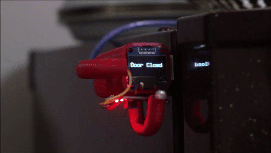

This device has an infrared sensor that activley detects the fridge door and during this time teh device will be on standby mode.
When you pull the fridge out the ir sensor detects no obstacle in front of it this will trigger an LED(you can also use buzzer) But the led was bright enough to alert.
Also to keep everything on the track i added an OLED screen that shows all the messages on real time.
Powered by usb and the device is very small to be able to carry and install in almost all versions of the fridge.

This is all about building this project, at this point the project is ready and only thing pending is the testing followed by installation of the device on the actual fridge.
Step 4: How to Use

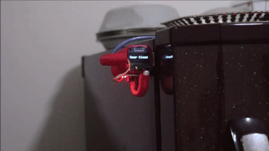

This is the most interesting part of the project, Before you put this on your fridge there are certain things you need to perform.
Test this project first by placing the hand or any obstacle in front of the IR sensor, if everything is working fine then you should see the led light off and the OLED showing door close as the message.
When you remove the hand from the IR sensor then the LED should start blinking and also the OLED shows door open as the message.
Now install this setup on the side of the fridhe, i chose the top left part of the fridge where there is plenty of space.
I had to stick a double sided adhesive to the back of this device just to make sure that the device wont come out if it is touched by mistake also.
The IR sensor can be adjusted also if the distance is too less and not be able to detect the door.
I chose power bank for power and you can do the same thing too.
