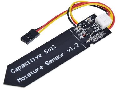

Each Moisture Sensor has three pins. One pin powers the device. Another pin is connected to ground. The last pin sends the data measurements of the moisture levels. The sensor itself acts as a resistor. When moisture touches the sensor the resistance goes down. When there is no moisture detected, the sensor sends a signal to the Arduino telling it to power the pumps and watering the plant.

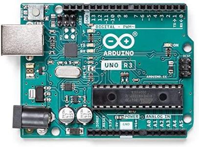

Any Arduino could be used, it acts as the brain of the circuit.

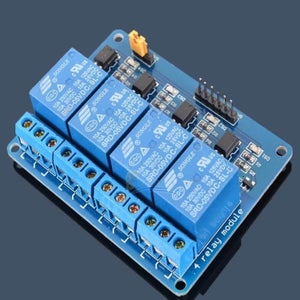

The Relay is what is used to power each pump and send water to the plant. The Arduino sends a signal to each pump telling it to turn on for a specific amount of time.
To power the Arduino, a 9V wall adapter is used. The Arduino is constantly on taking measurements.
The pumps need to be powered to run. A 9V battery is connected to the relay to power the pumps when the Arduino gets signaled.

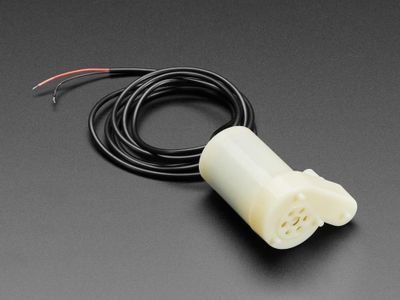

The water pumps are what sends the water into the plant bin

Two of the sensors are longer than the other two sensor wires. The bin itself was roughly three feet long and about a foot and half wide so to measure the overall moisture two of the sensors can be placed near the ends of the box.
The ground wire to each sensor was soldered together and then connected to ground. The same thing took place for the power wire to each of the sensors as well as the ground and the power wires connected to each of the pumps.
