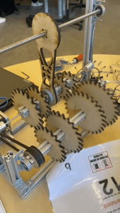

Step 1: Lasercutting the Gears
The following files were lasercut in such a way that they can be inserted onto an item schaft. The other half of the gears can be connected onto a second shaft (the output shaft). On the bottom shaft (input shaft) you also have to connect the tooth gear together with two stoppers. Put screws in between the gears so they won't slip off.
Step 2: Constructing the Frame
Once you have the shafts with the gears connected, you can start making the frame. For the basis of the frame you connect four item rods, with four vertical rods. These rods will allow to connect the input and output shaft through the ball bearings.

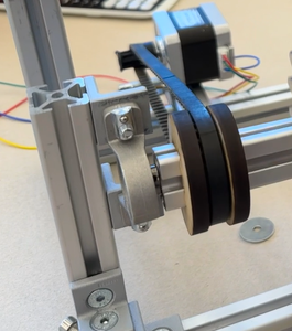

Step 3: Connecting the First Stepper
In order to connect the first stepper motor, you need to connect the first stepper motor to the item frame. The stepper motor has a 3D printed connector (see file). This way the connector and tooth gear are connected with a tooth belt. The stoppers will prevent the tooth belt from slipping off.
Step 4: Making the Linear Actuator and Output Shaft
Output shaft
With the input shaft put into place it is now time to construct the output shaft. The matching gears cut during step 1 can be assebled in the correct order. When placing the gears, ensure that there is enough spacing, so the gears will not jam when trying to move gears (since two gears might be connected at the same time). Tip: try to keep the distance on one shaft fixed (output shaft) and try to match the other shaft in an appropriate way.
In the middle of these gears a PVC tube that fits tight around the item is placed (diameter of 28 cm), with over this a PVC tube that is able to freely rotate (diameter of 32 cm). This second PVC tube is placed inside a laser cut connector (see file). Between the PVC centre and the first two gears, springs are connected. This way the gears have time to 'wait' for the teeth to match so it can shift gears. In the centre of the output shaft is a non rotating thin metal rod, which allows for a free rotation along the correct direction, while constraining rotational margins.
