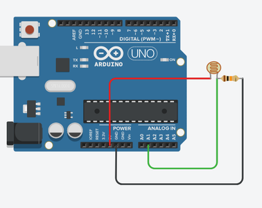

Step 2: LDR Sensor
you a photoresistor sensor and a 10k resistor to make an LDR(light dependent resistors)
Connect one pin of the photoresistor sensor to 5v of the Arduino, connect the other pin of the photoresistor sensor to one pin of the resistor and connect it to analog 0, connect the other pin of the resistor to gnd
Testing the resistor
after building the circuit test the sensor, put the sensor at night outside to record the value, note the value down
code=https://www.mediafire.com/file/aqtwpj32l2bo6mn/light%252Bdependent%252Bresistors_%25282%2529.zip/file
