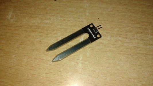

A Moisture sensor is used to read the Moisture content of the soil. The LM35 Temperature Sensor reads the ambient temperature.

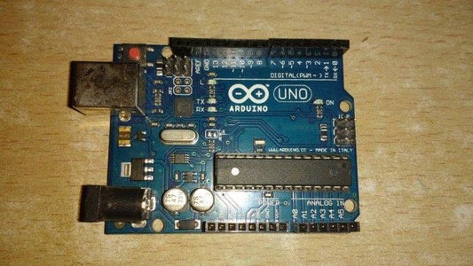

Arduino UNO is the brain of this system and all the sensors and display devices are controlled by it.

The Soil Moisture Sensor values depends on the resistance of the soil. The LM393 Driver is a dual differential comparator which compares the sensor voltage with fixed 5V supply voltage .
The value of this sensor varies from 0- 1023. 0 being most wet condition and 1023 being very dry condition.

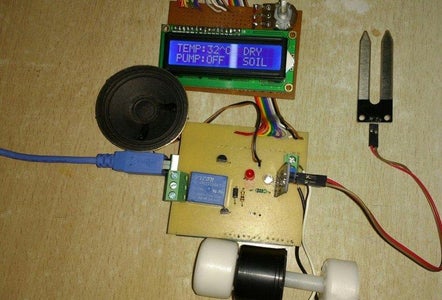

The Arduino reads the status of the soil using Soil Moisture Sensor. If the Soil is DRY it does the following Operations....
1) Checks for the availability of water using water level sensor.
2) If the water is available, the Pump is turned ON and is automatically turned OFF when sufficient amount of water is supplied.

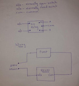

The Pump is Driven by a Relay driver circuit.
3) If the Water is Unavailable, you will be notified with a sound.
The Status of soil( Dry, Moist ,Soggy) , the temperature and the status of Pump is displayed on the LCD Screen.

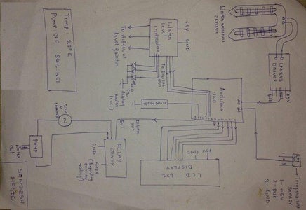

Step 3: BUILDING UP THE SYSTEM( CIRCUIT CONSTRUCTION)
Pleas refer the circuit diagram and build the circuit accordingly.
The Arduino Connections are given below._________________________________________________________

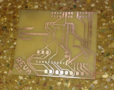

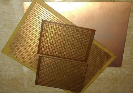

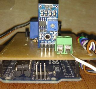

I have built this project on the Printed Circuit Board. It can also be constructed on Breadboard.

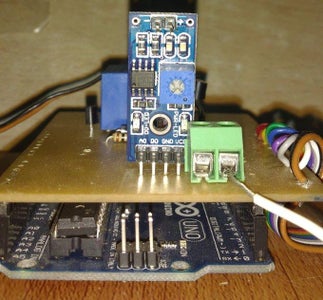

I have designed the Arduino shield for this project and all the components like Led, relay, etc are embedded in the shield itself.
You can refer to my video and instructables on how to make a PCB in this link..

Step 4: UPLOAD THE CODE TO ARDUINO
The Arduino Code is written by me for the specific task of Automatic Irrigation.
This Software is distributed in the hope that it will be useful but WITHOUT ANY WARRANTY; without even the implied warranty of MERCHANTABILITY or FITNESS FOR A PARTICULAR PURPOSE.
Procedure
1 Connect the Arduino to your computer.
2 Download the attached code and open it.
3 Select your COM Port and your Arduino Board from Tools Option.
4 Click Upload Button.

Step 5: TESTING AND IMPLIMENTATION
The following steps can be followed to test the project.
1) Connect the Arduino to power supply (5V) via USB or External power source.
2) Dip or bury the moisture sensor in the soil. Better place the sensor near the roots of plants for accurate measurements. Do not short the terminals.
3) Connect the Water pump to the Relay (N/O and Common terminals) and switch ON the mains. Refer the Circuit for connection details and pin out. WARNING: HIGH VOLTAGES . UNDERSTAND THE WIRING BEFORE YOU PROCEED.
4) The temperature sensor can be placed on the PCB itself or on the soil. Do not immerse the sensor in water.
Congratulations!!! You have successfully set up the system for irrigating your plants automatically!!!.
