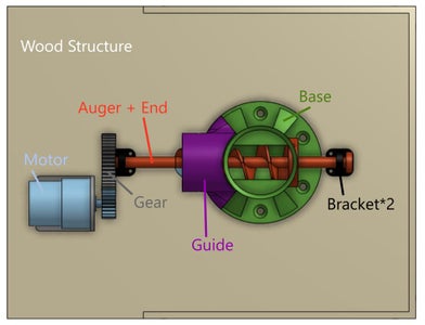

Step 1: 3D Printing the System
We'll start by looking at the mechanical aspects of our distributor. It operates mainly through the rotation of a worm screw, which is driven by a motor. This is why the first step is to print all the parts of the dispenser in PLA. Personally, I printed the whole thing with 20% fill. I'd also advise you to print with tree-shaped supports, to make it easier for you when you have to remove the supports, particularly around the worm screw.
WARNING : Print the 'PipeConnector' only if you want to distribute to 2 cats/dogs. Print twice the 'Bracket'.

Step 2: Create the Wood Structure
For the creation of the wooden structure, which is supposed to enclose the system, I think you'll probably have to adapt it according to your own constraints. For example, if you want the system to be lower for the bowls and so on.
However, I'll leave you with a sketch of my wooden structure from which you can draw inspiration.

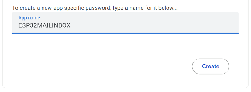

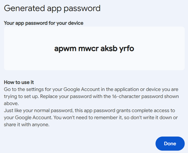

Step 7: Create a New Gmail Account for ESP32
To be on the safe side, I advise you to create a new gmail address. Then, to make access to your account more secure, we're going to create an application that will generate a 16-character code for you to copy into the program.
