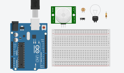

Step 1: Components Used in This Project
The parts used in this project are:
  • Arduino
  • Bread board
  • PIR Sensor
  • LDR
  • Slide switch
  • Light bulb
  • 1 10k Ohms resistor
