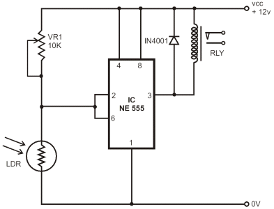

Step 4: Building the Custom LDR Sensor
At first i used off the shelf ldr sensors but for some reason my code was having trouble with it. So i decided to build my own. I used a prototyping board and a basic 555 timer IC with minimal components. The circuit is very basic. I built two on the same bread board and connected an LED and a wire with the output of each which is pin 3 on the 555 timer ic.

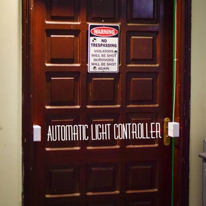

Mount the pair on both side of the door sill just below hand level. Run a wire between the two either from below or above like i did it. This will be to power the transmitter side. Run another wire to your electrical panel where you will wire the relay inline with your light switches.
What i did was add a switch on the power supply of the receiver so that i can turn the system on and off as i want. The lights were wired on the relays normally closed side so that if the system malfunctions i can just turn it off and normal operation will resume.
I aimed the laser diodes and then placed covers on both the sides to make it look more neat.

This was a great little project and it really does work. Its so fun when you walk out and lights go out automatically. It does have an issue when two people walk in at the same time or if a person stands in the door way. Still figuring out the solution.
