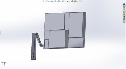

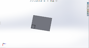

Plate should have enough space to fit the servo motor, the battery pack, the bread board, and the arduino microcontroller. My plate has a dedicate spot for the servo motor.

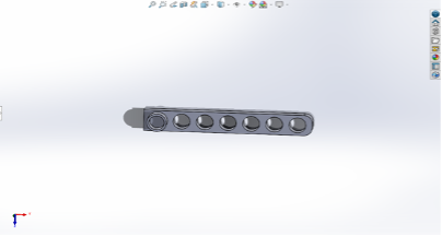

The servo crank attachment should have an inner diameter about .01 inches larger than the servo motor to prevent slipping when lifting and lowering the light switch. You might have to experiment with the diameter based on 3D printing tolerances. It should also have holes for the arm.

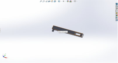

The arm should have a peg with an outer diameter .01 inches less than the holes of the crank. The rectangular hole can be adjusted based on the dimensions of you light switch.
Step 2: Put the Device Together
  • I used hot glue to attach the battery pack, the servo motor, and the crank.
  • The crank is glued to the servo to prevent slipping.
  • The arm is attached to the crank with a cap.
  • You might need to use hot glue if you sand down the peg on the arm too much.
  • The arduino board is connected to the plate with a velcro strip, and the breadboard is connected to it with its own adhesive.
  • The back of the plate also has a velcro strip to connect to my wall
