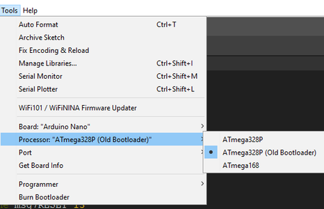

Lastly when uploading you need an FTDI adaptor for the Arduino pro mini. When selecting board, it is a Arduino nano and you need to select "Old Bootloader" under processors
