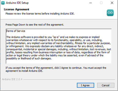

Step 4: Select "I Agree" on the Window That Pops Up

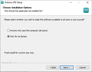

Step 5: Select the Option for "only Me" and Click Next

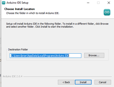

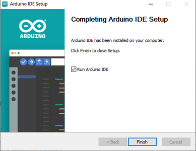

Step 6: Choose the Destination You Wish to Install the Software and Click "Install"
Step 7: Click "Finish"

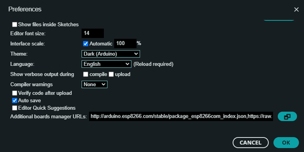

Step 8: Open Up the Arduino IDE Software and Click "File" in the Upper Left Hand Corner of the Screen
Step 9: Scroll Down to Additional Boards Manager and Paste the Link Below in the Additional Boards URLs Section
https://raw.githubusercontent.com/espressif/arduino-esp32/gh-pages/package_esp32_index.json

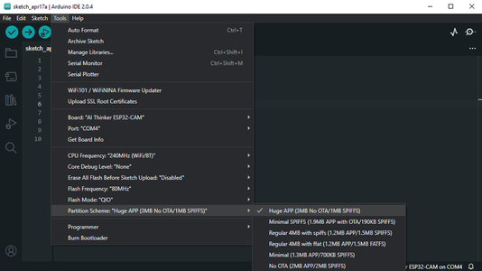

Step 10: Click on Tools, and Navigate Down the Menu to the Board Section. Click on That and in the New Menu Click on "Boards Manager"
Step 11: Search ESP32 in the Boards Manager and Click Install on the ESP32 by Espressif Systems Board Set
Step 12: Plug the ESP32 Into Your Computer or Laptop. Click the Arrow in Selecting Your Board and Choose the USB Serial Port. Select the Board Type "AI Thinker ESP32-Cam"
Step 13: Click on Tools and Navigate to "partition Scheme". Click on That and Select "Huge APP (3MB No OTA/1MB SPIFFS)"
Step 14: Ensure That the CPU Frequency, Core Debug Level, Erase All Flash Before Sketch Upload, Flash Frequency, and Flash Mode All Match the Settings Within the Pictures Provided

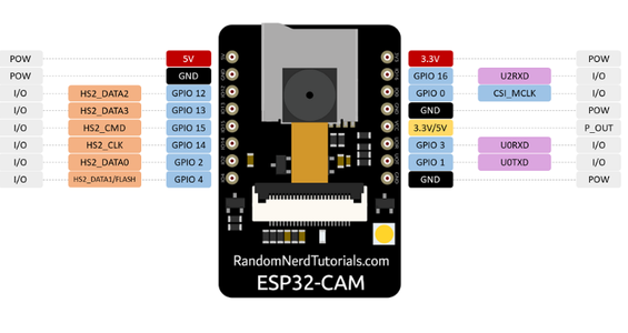

Step 50: Connect the Positive Terminal of Each Servo Together.
Step 51: Connect the Negative Terminal of Each Servo and the GND Pin From the ESP32 Together.
Step 52: Connect Pin 14 on the ESP32 to the Swivel Servo Signal Pin
Step 53: Connect Pin 15 on the ESP32 to the Trigger Servo Signal Pin
