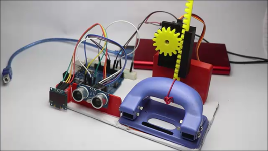

I wanted a device that is automatic and when you simply place the paper it should punch the hole and after think for some time i thought of this design and went on to give a try

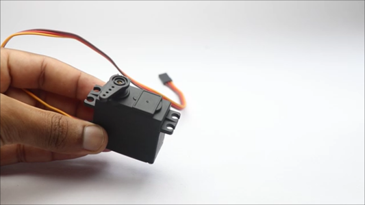

I made the mechanism using 3d printed parts so that it is accessible to most of the people, The choice of motor was MG995 since the handle of my punch needed more load to work and punch the holes
I also recommend you guys to use MG995 servo since it has got a great torque and has metal gear that will assure great torque at the time of working
The real challenge in this project for me was to achieve a press mechanism, I came up with this setup after a lot of trial and error and also it needs a lot of refinements
If you find any simple mechanism setup that could do this job let me know in the comments box i will be happy to consider all your suggestions
I tried this and the results were satisfactory, if you are building this project i have given all the sources like program, circuit diagram and videos for better understanding

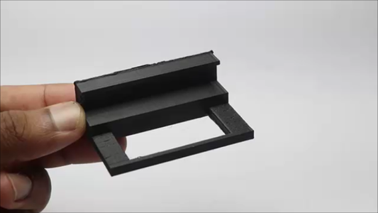

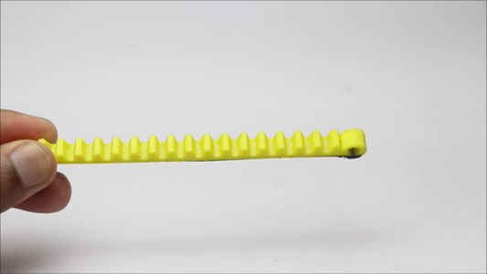

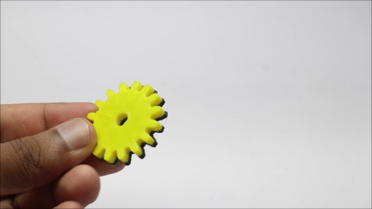

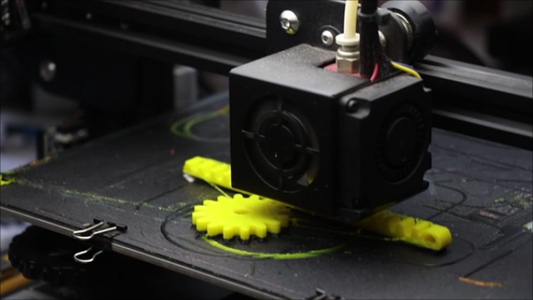

Step 1: 3D Designing and Printing
I have designed all these components for this project using Tinkercad application
There are total of 3 parts in this project, The Body, Gears, Slider and overall print time for this project is less than 3 hours
I have sliced the models using cura slicer and later imported the model to printer and later printed them

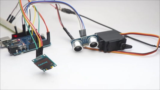

Step 2: Circuit and Program
The circuit seems complex at the first look but it is not, let me even break it down even more so it is understandable even for a absolute beginner

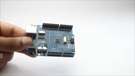

Circuit consists of 3 main components, Ultrasonic sensor, OLED module and Servo and apart from this we can also say that this has 2 different circuits
The first circuit is powered by UNO board and has all the components except the servo, we are using separate circuit for servo since it consumes too much power and arduino board power cant do the job
For this reason i will use 2 seperate power source one will power the arduino and the other will power the servo

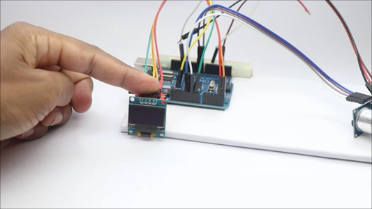

Connections that makes this circuit work is as follows

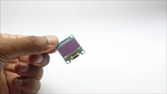

OLED comes with 4 pins
Scl to A4
Sda to A5
Vcc to 5v
Gnd to Gnd of Uno

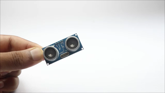

Ultrasonic as known and HCSR04 connections
Echo to D8
Trig to D9
Vcc to 5v pin
Gnd to ground of Uno
Servo Connections
Servo Gnd is connected to power rail gnd, Gnd of arduino to this ground and the ground of power source to the power rail this will create a common ground
Vcc of servo to 5v pin on adapter
Signal is connected to D6 pin of the arduino uno board
After you made this connections, u can upload program to arduino board
Conect uno to computer, open arduino ide, paste this program and select proper board type and click on upload and now you are good

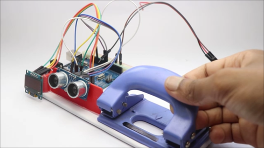

Step 3: Assembling Circuit
This is the step where you will feel your project coming to life since we are merging the electronics part to look like actual project

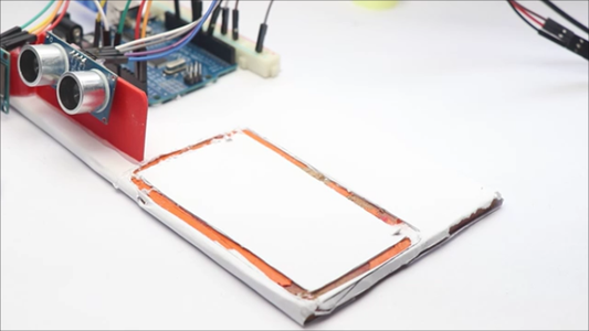

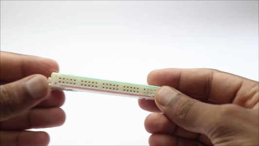

I will start by preparing the piece of board, Use double sided adhesive to connect uno with the board
If you dont have it use mild hot hotglue for this purpose, allow to dry completely and then remove the back sticker of breadboard power rails and stick on the board
I will use a small piece of 3d printed tube to make a stand that will hold the OLED module, and another piece to hold the ultrasonic sensor

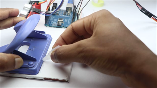

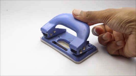

The white sheet of board that i used had a layer of paper underneath, this needs to be removed before gluing base of the punch device to adhere properly to the base
Mark those layers first and now add superglue to the base of the machine and later press the base to this and wait for some time

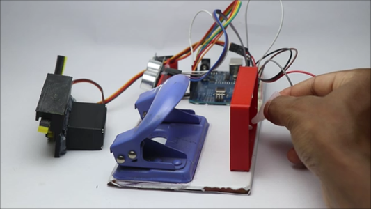

At this stage we have the punch machine ready and we only need to add the working mechanism of servo slider and now we will see how we can achieve this

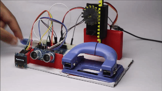

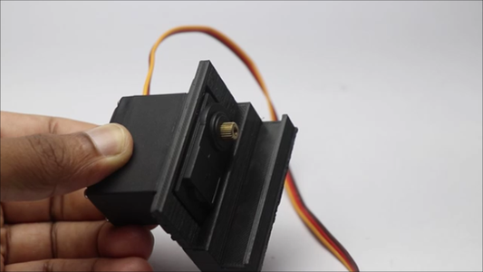

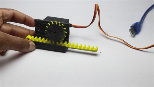

Step 4: Preparing the Mechanism

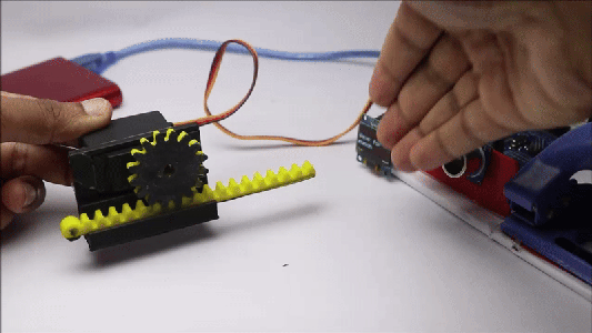

Before installing the mechanism on the sheet of board first you need to check for the working of slider and servo

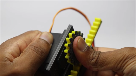

To do this all you have to do is connect the frame of servo to the MG995 servo first and secure the edges with hot glue and allow to dry completely
Place the slider to the servo holder part, Now attach the gears to the servo shaft, if needed add the screws to shaft for good strength

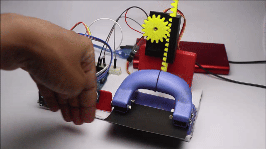

Power the servo part first and then connect power to arduino uno, When you wave the hand infront of ultrasonic sensor the slider will start to slide
First it will slide counter clockwise and then after few seconds it will go back to its original position
Check for this action multiple times and if needed you can adjust the position and placement of slider too
This can now be installed to the board, use superglue for the purpose, use metal wire to connect this mechanism to the punch device handle
The strong threads are also a great option to consider, The flexible wires dont work well and you need to look after this fact
It was a little tricky for me to connect these two parts together, anyways i have showin in a very simple way in my video and you can consider watching that

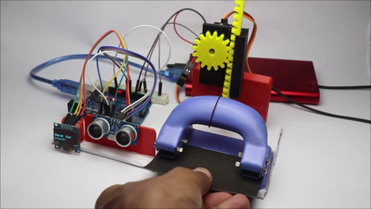

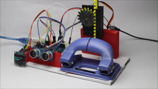

Step 5: How to Use
Using this is simple but the real question is when you will actually use this
The situation arises where you need to punch a lot of holes, if you think of a situation where you need to punch hole for 100 paper by listening to this question only you are worried!

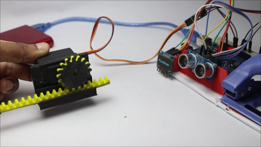

In this circumstances this device is super useful, all you have to do is connect this device to USB source in my case i will be using power bank
The mg995 servo cant work properly with on board power supply so i will use a 5v adapter to power this servo

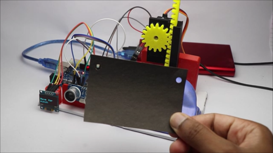

When both are connected to power supply the OLED module will show message, Now to test this all you have to do is wave your hand infront of the ultrasonic sensor
The servo will be triggered and now you can keep the paper that needs the gole to be punched, you can wave again and place paper below to make the hole
Repeat the steps a hundred times and you can make holes effortlessly without any problems
There is a issue that needs to be improved here, since the mechanism is using too much torque the base of the servo is not able to handle the load effectively so it gets bent a little when the hole is being punched
Not a problem but still if the mechanism is distributed very well this can be minimized to a larger extent, Let me work on this and if you know any solution im willing to hear your comments
