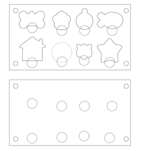

  • Aluminium Pet tags (Alibaba link). It is important that you use the tags from the supplier in the link. The bed (where the tags are placed) is specially designed for this models. Of course you can design the bed with any shape you want but that is out of the scope of this instructable. If you need help making a bed that fits your tags feel free to reach out on twitter. Meanwhile, you can print in a sheet of paper this file and see if your tags will fit

You will need access to a laser cutter to make the bed. Grab the SVG file in this link, right click on it, save it and laser cut it. You will have to sand paper the holes a little bit, make sure that the tags fit tight.
You can print the SVG file with a normal printer in a sheet of paper to see if your tag will fit. If you are using other tags with different shape you will have to modify the file with Inkscape or make one from scratch.

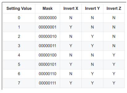

To enable Homing, set $22 = 1 (Homing cycle, enabled). Now when you send the $H command, or press the “Homing” button, the CNC should raise the bit, and seek to the home position. If you find it is seeking in the wrong direction, you can tell it to invert an axis for homing, by setting the value of $23 according to the table attached.
If moving the spindle bit using the Jog Controller moves it in the “wrong” direction that you expect, you most likely have to invert that particular axis. This can be done using the $3 variable, using the table attached.

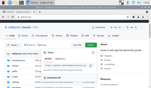

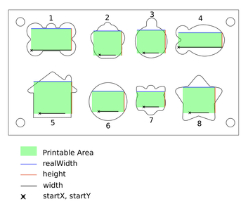

Now we are going to download Tessie, it will provide the user interface to select the tag, generate the gcode and send it to the CNC through UGS. Decompress the file and go to the settings folder, there should be a settings.json file. You need to change startX, startY and startZ for each tag.
"tag1": {
	    "startX": -153,
	    "startY": 54,
	    "startZ": -4.09,
	    "width": 31,
	    "realWidth": 31,
	    "height": 17
The first 3 settings determine where the spindle will start engraving relative to the home position (the home position is 0,0,0), So, before looking for these values you have to home the machine and set to zero.
For some tags, it is not possible to position the spindle in the bottom-left corner of the "Printable area"; for that reason the "width" is less that the "realWidth" in some tags. "height" is the height of the printable area. Please refer to the image that I attached in this step as reference.
To find startX and startY place an aluminium tag in the bed and using the Jog Controller move the spindle to the position marked with an "X" in the image attached. Update your settings.json file (startX and startY) with the values that you get in UGS when you reach that position.
To find the startZ value move your spindle to the center of the "Printable area" and start moving the spindle down until a sheet of paper can barely move between the tag and the spindle. You can adjust the step to 0.01 mm to reach a very precise value. Now, update your settings.json file with the value of startZ.
You have to find these 3 values for each tag. The width, realWidth and height should only be changed if you are using other tags.

Before engraving we need to install node.js in the Raspberry Pi. There are many tutorials on the web, but I used this one
Now open the folder that you decompressed when downloading Tessie and press F4. A terminal should open, now run:
npm install
After the packages are installed run:
npm run dev
If everything is OK you should be able to go to localhost:5000 in your browser and see the interface.
