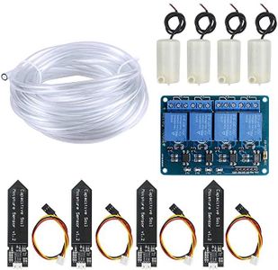

1 5v Pump
Airline Tubing
1 Capacitive Soil Moisture Sensor

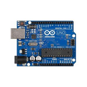

1 Arduino Uno

In order to get the signal of the moisture sensor, plug the corresponding wires to ground, any analog pin for the signal, and 3.3v for power. Then, wire the led strip with power, ground, and any digital signal. Next, wire the relay by using power, ground, and another digital signal. Then power the pump using an external power source. I cut up an old usb cable and connected the power of that to the power of the pump. Then connect the grounds of the power cable and the pump to the relay. A relay works essentially as a switch. It has a common wire, an nc (normally closed) wire, and a no (normally open) wire. I choose to connect the ground of the pump to the common and the ground of the power source to the normally open. When the relay turned on based on the signal coming in, the normally open and common would complete the circuit and run the pump. I also set a digital pin as an output to create another power pin on the board.
Step 3: Code Accordingly
Follow the code to set up the system. The pins are defined at the top and then there is some logic to control the lights for a set amount of time. You can play around with the signal of the soil moisture sensor to determine when the soil is wet and dry and then set the level at which you want the pump to turn on.
