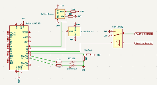

Step 1: Assemble Electronics
Wiring Instructions:
Connect A5 and A4 to separate pins on the breadboard. Place a resistor after both A5 and A4 that is valued at 110 ohms. After that place a green LED connected to the A5 circuit and a red LED connected to the A4 circuit. Finish by connecting both LEDs to the ground.
A3 is the push button. When setting up the pushbutton, place one side of the pushbutton the A3 signal. On the same side place a 110 ohm resistor in parallel to the ground. This will allow for the button to be an active high push button. On the other side of the pushbutton connect to the 5V output of the Arduino.
A2 will connect to the Relay and the solenoid. For the relay, A2 will connect to the signal pin, the ground will be connected to the ground pin and 5V will be connected to the VCC pin. At the other end of the Relay, the solenoid will have one connection to the NC pin and one connection to the COM pin.
A1 connects to the capacitive sensor, to the pin label Aout. Pin GND will connect to the ground and pin VCC will connect to 5V.
A0 connects to the optical sensor. A0 connects with the yellow wire of the optical sensor with a 10k-ohm resistor in parallel connected to ground. The red wire of the sensor will connect to ground and the white wire will connect to 5V. The blue wire connects to a 440-ohm resistor connected to 5V.

Calibrating your sensor:
In the Arduino IDE open your code file. Open the live serial monitor. Note the reading of the moisture sensor in air and submerged up to the line on the sensor in water. Then do the same but in dry soil to get a base reading. The values may need to be adjusted for your individual sensor.
The next step is to place the optical sensor into the water bottle. Please note that the green LED light will not turn on initially as there is no water in the bottle. It should turn on once water is added. If it does not turn on, please check your connections and your code.

Step 7: Test the System
After you have calibrated the sensor, you can try pressing the red push button. The red LED should light up, and the valve should be in the open state. Please note that if your red LED or valve does not function properly after pressing the push button, please check your code and connections to ensure they are correct.
