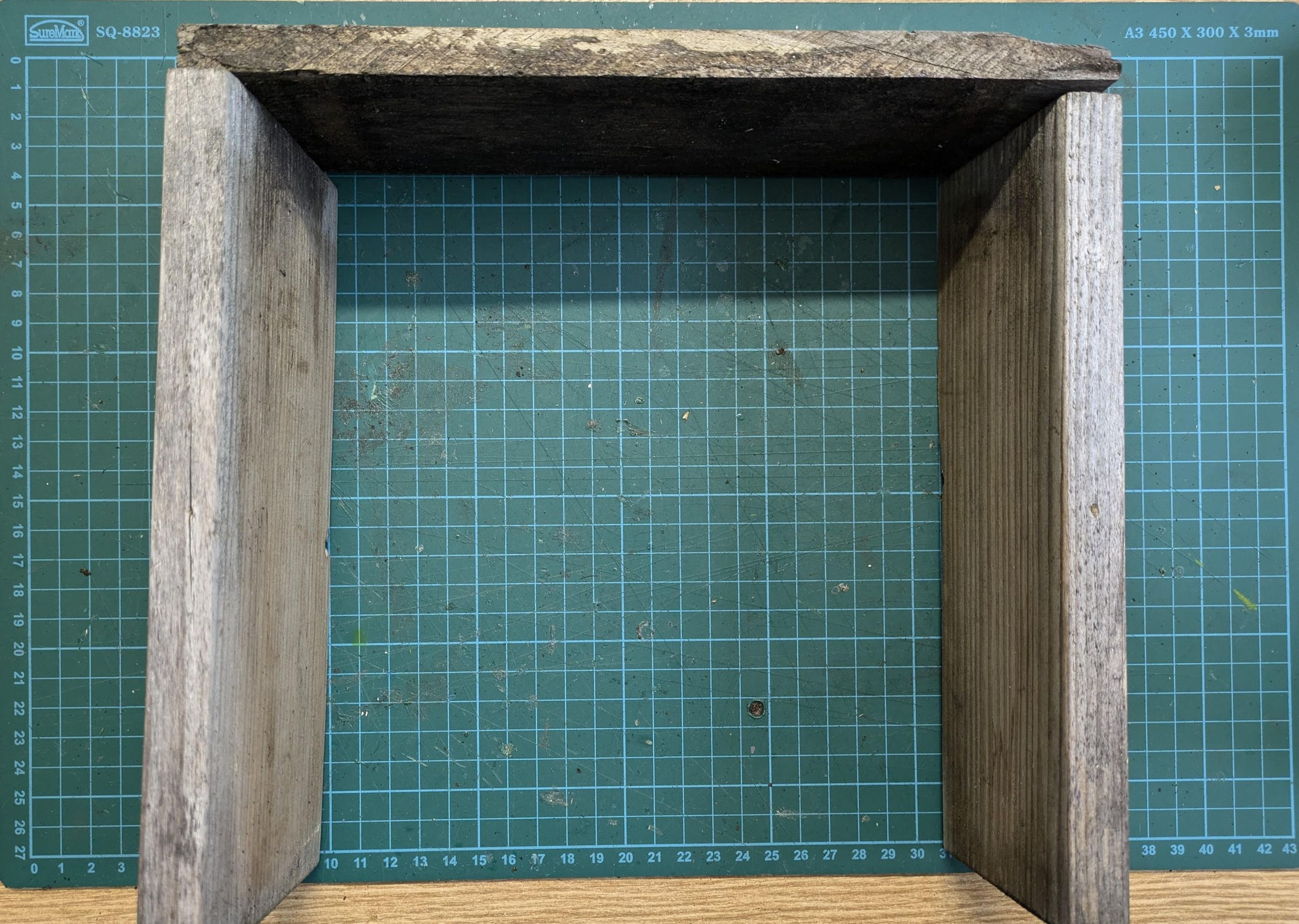

Step 2: Assembling the Frame
The frame is one of the easiest parts to assemble for the watering system. You need 3 wood planks, 4-6 screws, a cordless drill or screwdriver and the 3D printed part named "Bottle holder". I recycled some parts from an old EPAL (Euro Pallet) to make my design even more sustainable.
1. You start by laying out the 3 planks in an upside-down U figure:

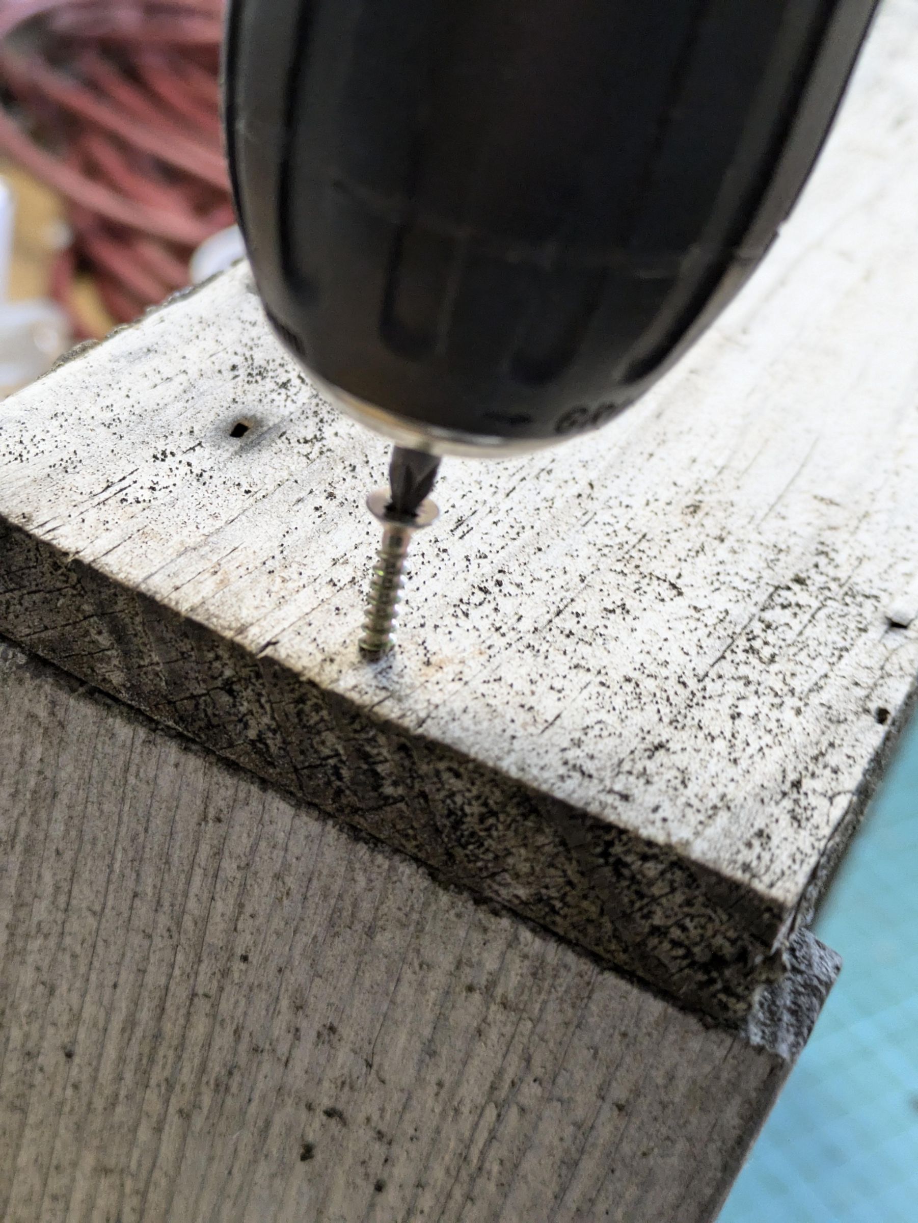

2. Then you can start drilling the 2-4 screws into the top plate like that:

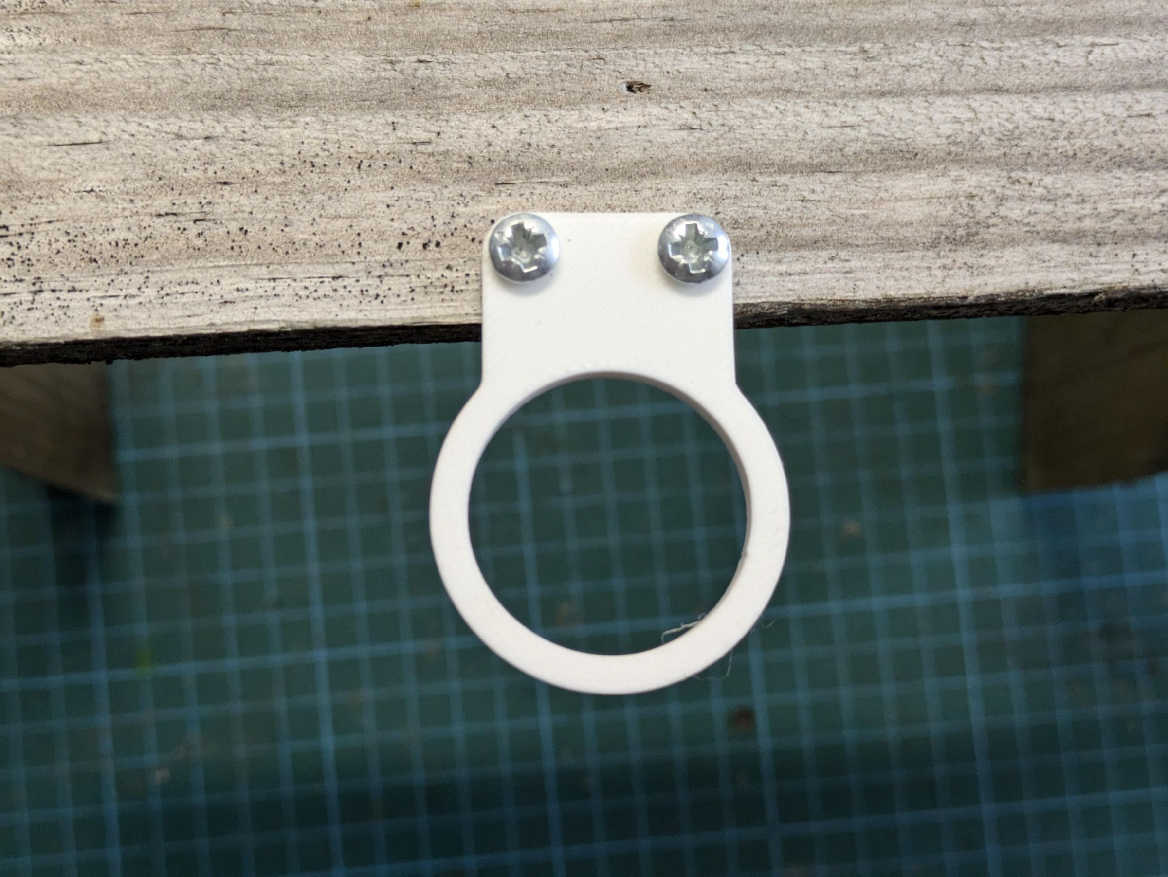

3. After drilling in the screws to connect the planks, you will need the leftover screws to attach the part "Bottle holder" to the top plank:
Now you are finished with assembling the frame, you can now continue to the next step - soldering!

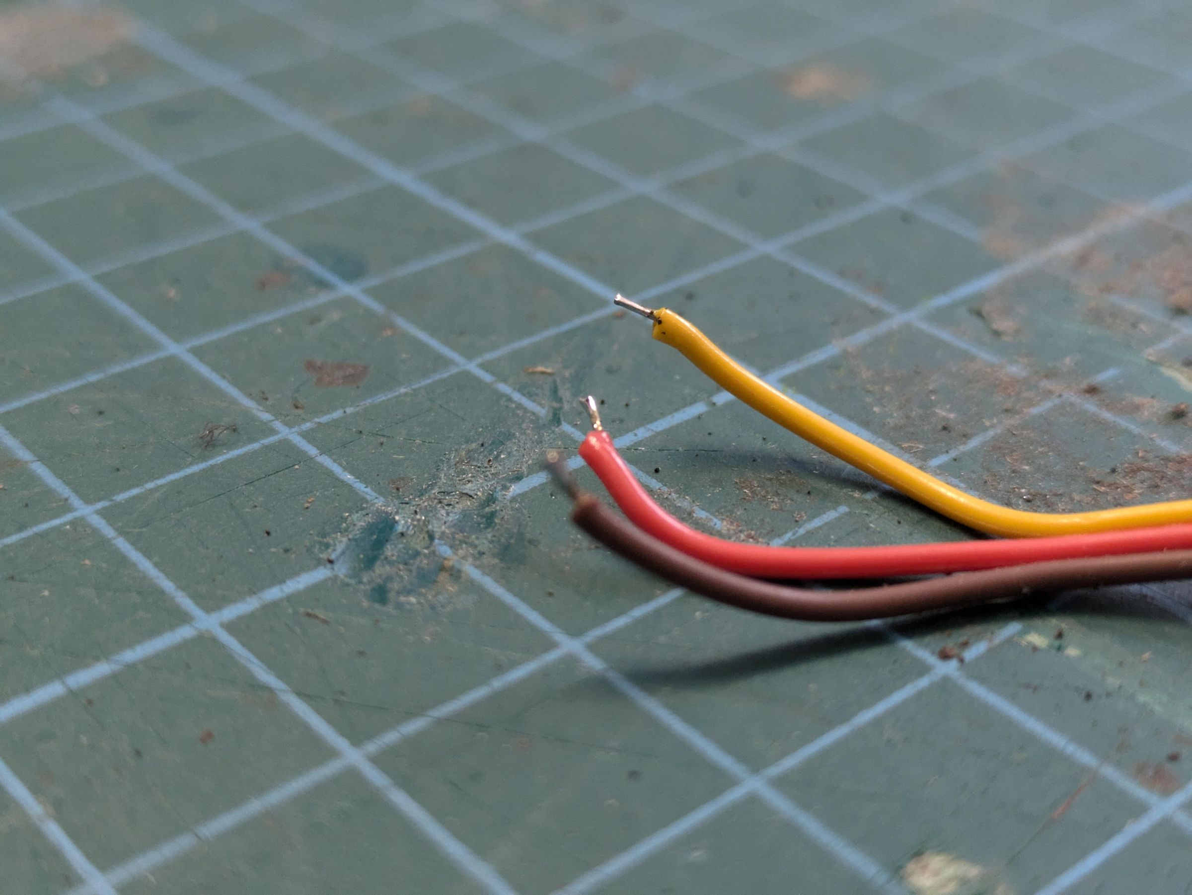

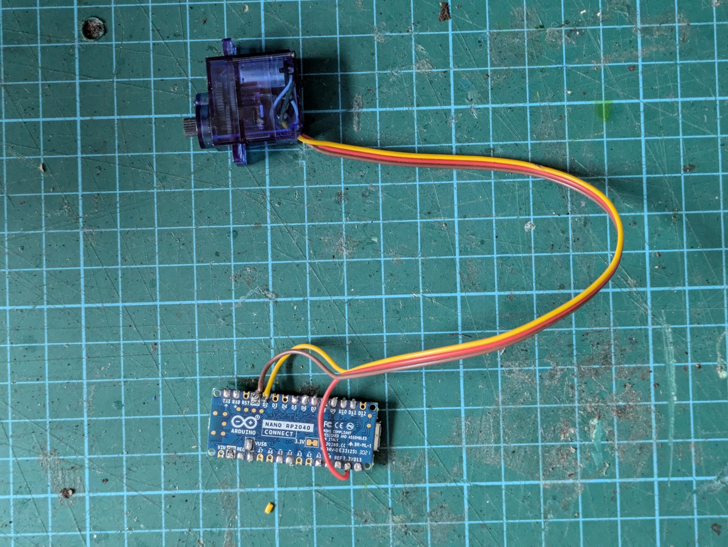

Step 3: Soldering the Electronics
You will only need to solder 2 parts to the Arduino. The servo and the moisture sensor, all of which are quite straightforward.
1. Tin the cables of both the moisture sensor and the servo to make soldering them easier.
2. We will start by soldering the servo to the Arduino. To do this, you will need to connect the black wire to GND, the red wire to 3.3V and the yellow signal wire to D2.
3. Now we will connect the humidity sensor. The black wire will go to GND, the red one to D3 and the yellow signal wire to A0.
We are now finished with the wiring and can start with the final assembly of the Plant Watering System.

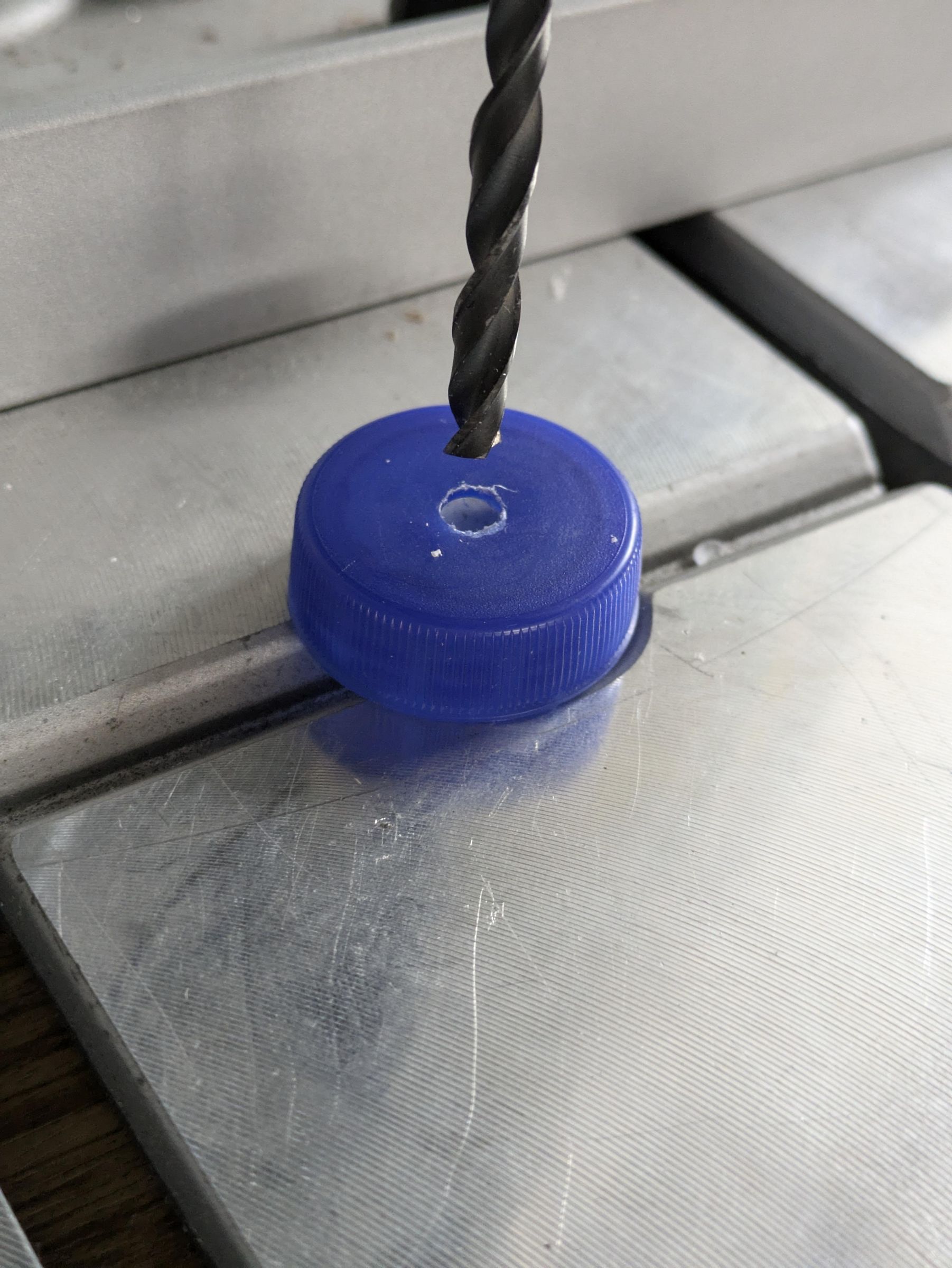

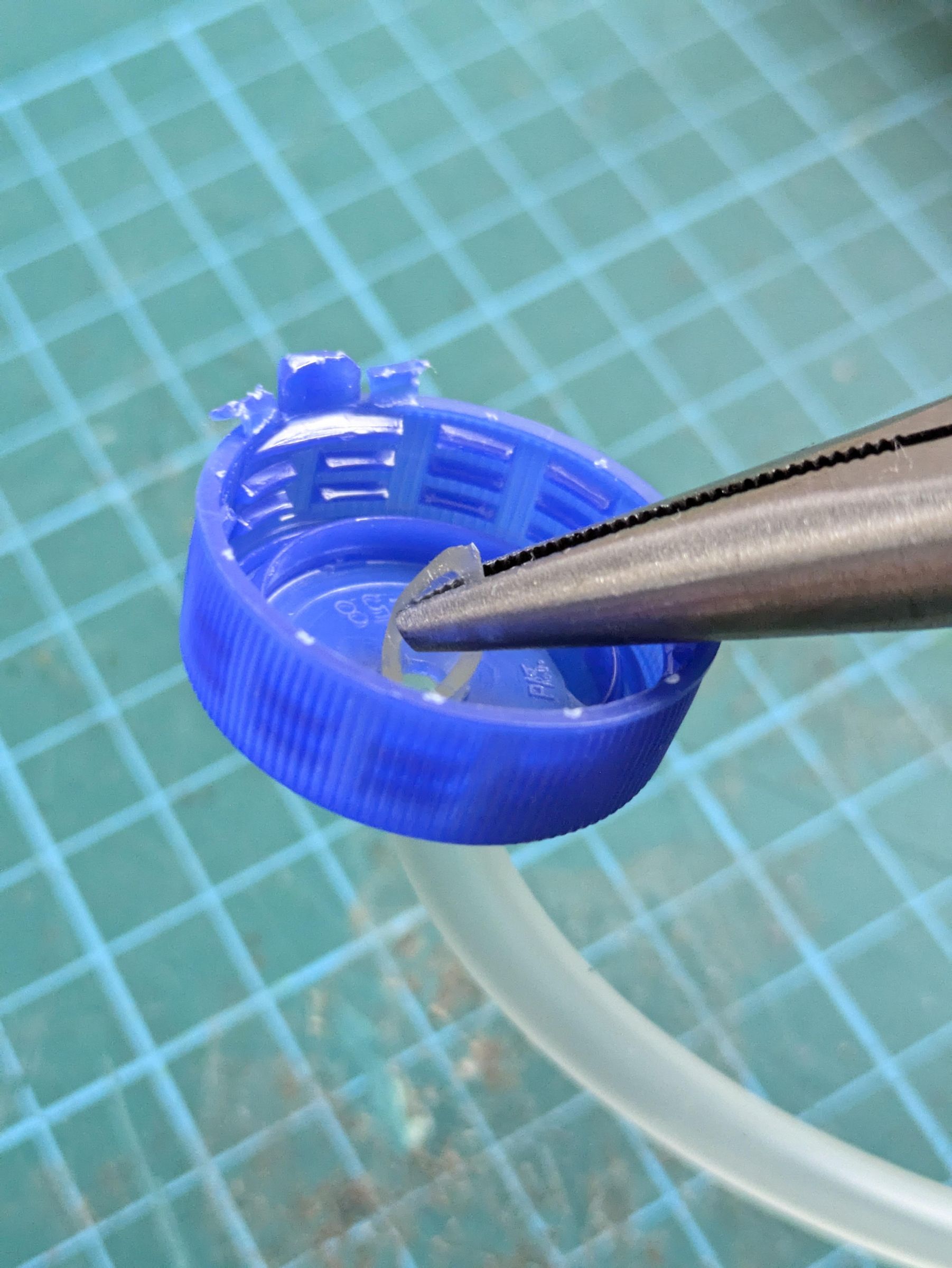

1. First, you should drill a hole into the bottle cap of the PET bottle, using the 5mm drill bit:

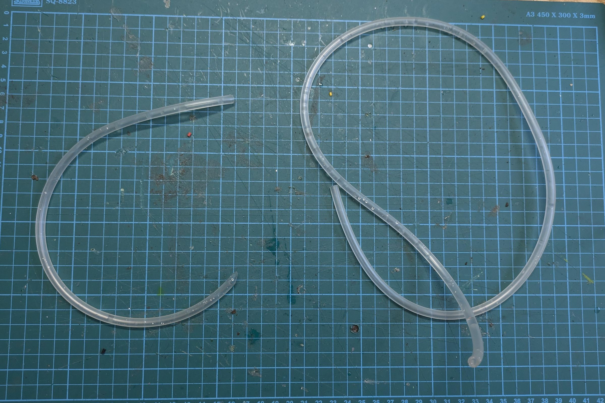

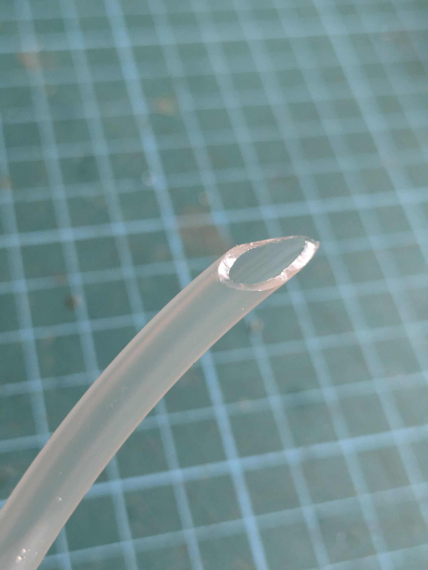

2. Now, cut off a third of the PVC hose:
3. Connect the shorter PVC hose and push it into the bottle cap. To make this step easier I recommend to cut off a small bit of the hose, to make it pointy:

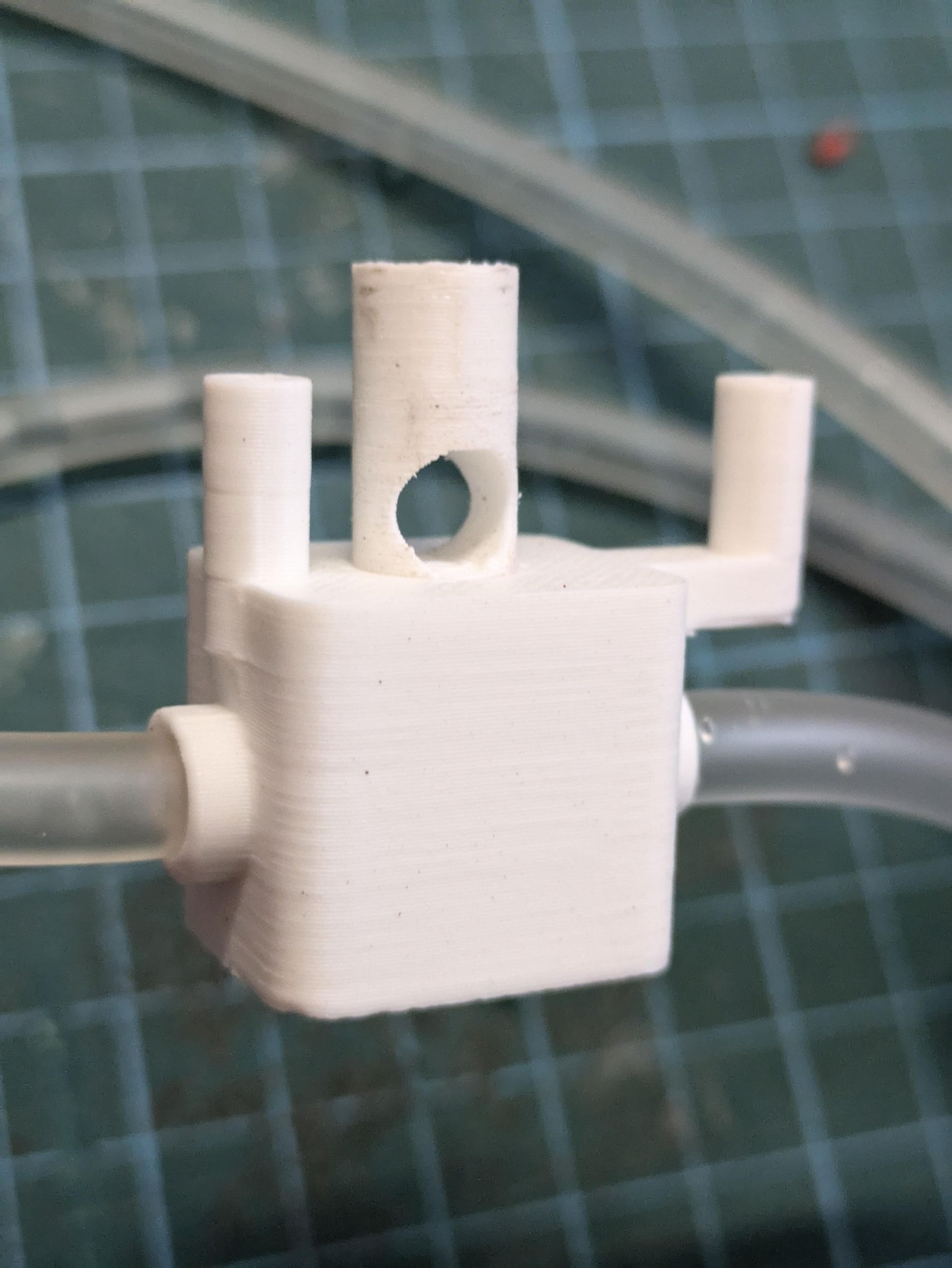

4. Push the other end of the hose, which is connected to the bottle cap, into the valve:
5. Insert one side of the other piece of hose into the valve. You can now also push the cylinder into the valve while remembering that it should be in the closed state (the hole isn't in line with the inlets):
6. To complete the valve, screw the servo to the specific holes made for it. Attach it using the included screws for the servo:

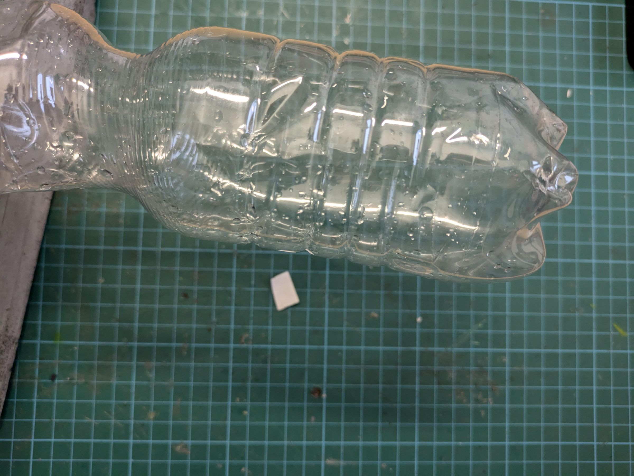

7. As the last step, you should make a tiny hole in the bottom of the PET bottle in order to not create a vacuum in the bottle, when the water is released:
