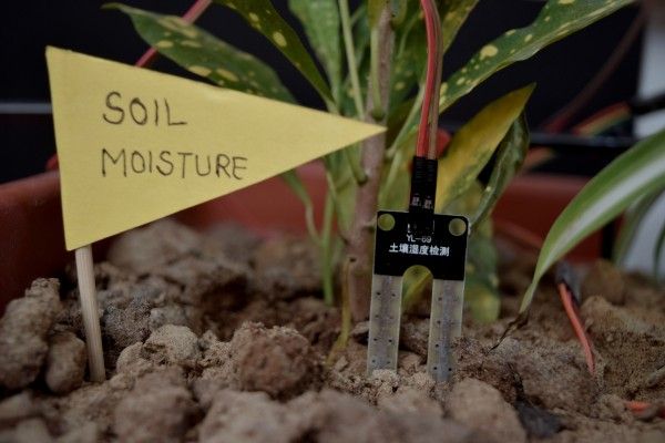

The secret device that we use for making the water pump system automatic is the Soil Moisture Sensor.
The Soil Moisture Sensor is used to detect the water level content of the soil. It has two electrodes that are inserted in the soil whose moisture is to be checked. You must be wondering how the electrodes are used to check the moisture content. Basically, they check the conductivity of the soil. The more conductive the soil, the more moisture the soil contains. Less conductive soil points out to less moisture sign.
Insert this Soil Moisture Sensor in the soil.
