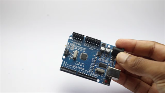

Arduino Uno

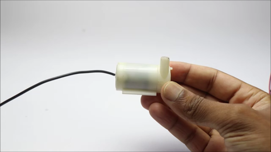

Submersible pump

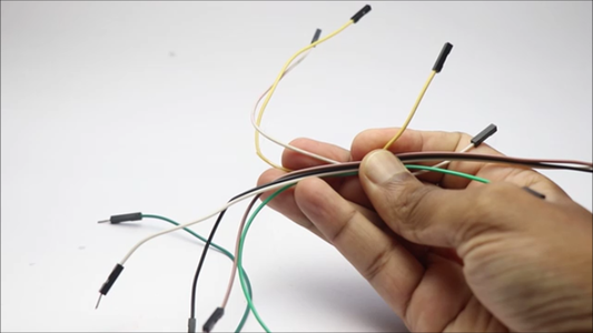

Jumper wires

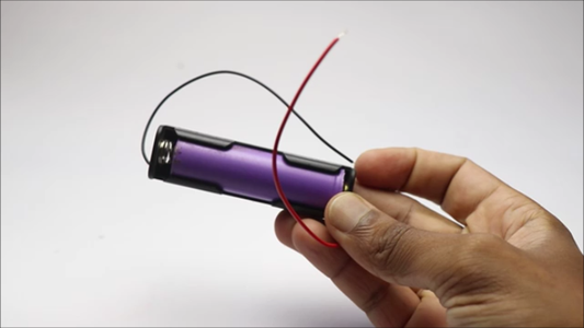

Battery holder
18650 battery

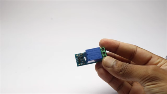

Relay module 5v

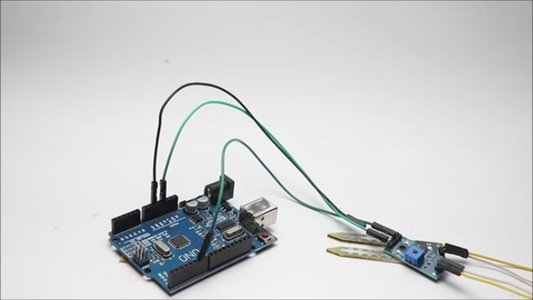

Step 1: Circuit Diagram
I will divide the circuit into 3 components, relay module, moisture sensor and pump, below is the connection for those components
Soil Moisture Sensor
  • VCC of the soil moisture sensor connects to the 5V pin on the Arduino.
  • GND of the soil moisture sensor connects to the GND pin on the Arduino.
  • DO (Digital Output) of the soil moisture sensor connects to D6 on the Arduino.
Relay Module
  • VCC of the relay module connects to the 5V pin on the Arduino.
  • GND of the relay module connects to the GND pin on the Arduino.
  • Signal Pin (S) of the relay module connects to D3 on the Arduino.
Submersible Pump
  • Connect one terminal of the submersible pump to the normally open (NO) terminal of the relay.
  • Connect the other terminal of the submersible pump to the positive terminal of the power supply for the pump.
  • Connect the common (COM) terminal of the relay to the negative terminal of the power supply.

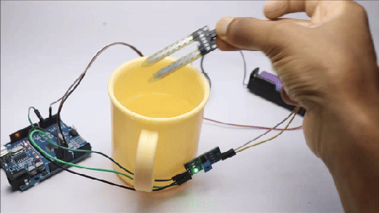

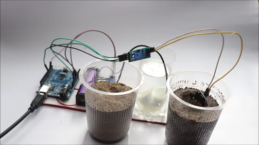

The working of this project is very simple, here the moisture sensor plays a very important role by detecting the levels of moisture in real time.
To do this all you have to do is dip the moisture sensor to the soil where the plant is growing and turn on the system, When the moisture sensor starts to detect low levels of water it triggers the arduino board to activate the pump.
The pump then turns on and keep circulating water for few seconds and then when the enough moisture level is achieved the pump turns of automatically.
You can see the sensor amplifier getting on and off when its dipped in water.

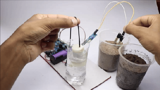

In the above steps i have shown a small model that represents the bigger models, In this step i will show you how you can implement this on a larger scale models.
The concept lies the same for all the models the sizing of the components differ, To be more clear let me explain by taking an example.
imagine you have multiple pots that needs to be watered, one easy way is dip the stick to all the pots and have a separate watering system, now you might be thinking what if i insert one sensor and have common watering system. This is not possible because different plant consumes different amount of water so when on pot is dry other might still have some moisture in it.
The electronics hardware depends on the scale in our case we used a small 5v pump but in different cases you might need a bigger pump.
