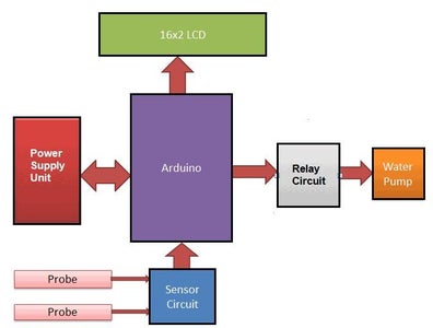

Step 1: Working of the Automatic Irrigation System
The Automatic Irrigation System with Arduino works by using a moisture sensor to detect the moisture level in the soil. The Arduino Uno microcontroller is programmed to read the sensor's values and activate a water pump when the moisture falls below a predetermined threshold.
  • Power on: The system is powered by a 12V power supply connected to the Arduino board. The power supply is regulated using a voltage regulator to provide stable 9V DC power to the Arduino Nano.
  • Sensor reading: The system uses a capacitive soil moisture sensor connected to an analog input pin of the Arduino.
  • Moisture calculation: The analog value from the sensor is mapped to a moisture percentage using predefined thresholds for air value and water value.
  • LCD display: The moisture percentage is displayed on a 16x2 LCD module connected to the Arduino.
  • Relay control: Based on the moisture percentage, the Arduino makes a decision whether to turn on or off the irrigation system. If the moisture percentage is below 30.0, indicating a low moisture level, the Arduino sets the relay pin to LOW, turning on the relay connected to the pump. This activates the pump and starts the irrigation process.
  • Pump status display: The LCD module displays the status of the pump on the second line. If the pump is turned on, it shows "Pump: ON". If the moisture percentage is above 70.0, indicating sufficient moisture, the Arduino sets the relay pin to HIGH, turning off the relay and indicating that the pump should be off. The LCD displays "Pump: OFF" in this case.
  • Monitoring and loop: The Arduino continuously reads the moisture level, updates the LCD display, and checks the moisture percentage to determine the pump status.
The water pump then delivers water to the plants until the moisture level reaches the selected threshold again. This automated process provides that plants receive the right amount of water, even when the owner is away, boosting their health and vitality

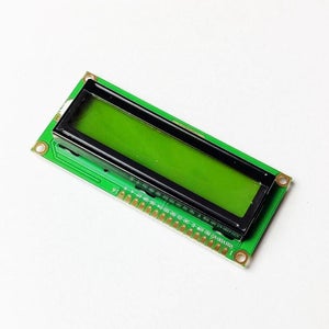

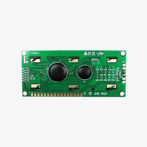

Step 3: 16x2 LCD Display
16x2 LCD is a display module with 16 columns and 2 rows, capable of displaying 32 characters. It utilizes liquid crystal technology and often includes a backlight for visibility in different lighting conditions.
The LCD module interfaces with external devices and is commonly used for character-based information display in various applications.
Specifications & Features
  • I2C adapter allows flexibility in connections
  • I2C Reduces the overall wiring.
  • 16 characters wide, 2 rows
  • White text on the Blue background
  • The single LED backlight
  • Character Color: White
  • Backlight: Green
  • Supply voltage: 5V

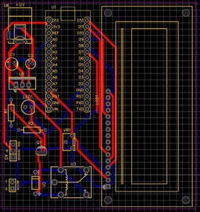

PCB Design, Gerber File -PCBWAY
If you don’t want to assemble the circuit on a zero PCB or a breadboard and you want PCB for the project, then here is the PCB for you. I used EasyEDA to draw the schematic first.
The Gerber File for the PCB is given below. You can simply download the Gerber File and order the PCB from PCBway at an affordable price.
