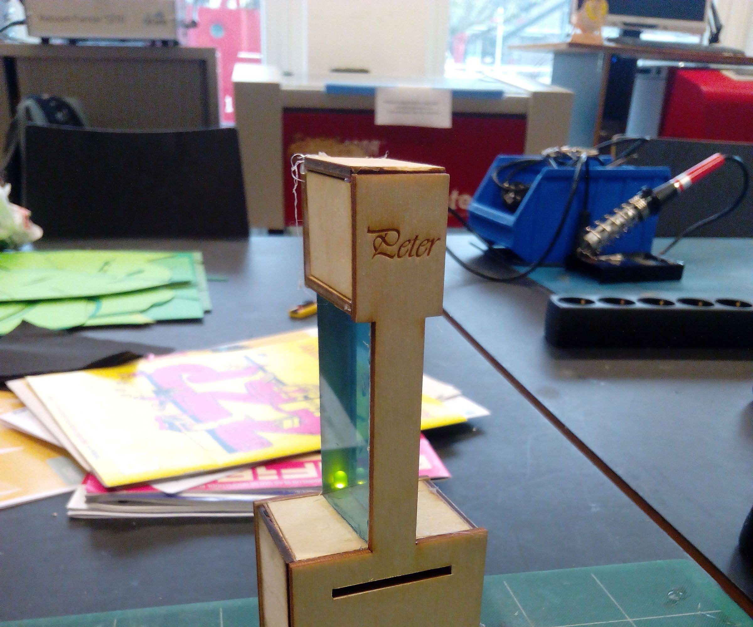

Step 1: Creating Your Arduino Case
In this step we'll need a lasercutter!
All you need is 3mm plywood and my caseplans!
(You can always create your own case if you want ofcourse).
Once you cut the parts out for the case you're already done with this step!
