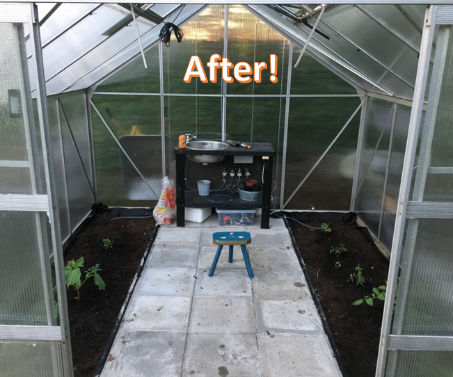

Step 5: Preparing the Controller and Table.
I bought a cheap garden table in my local hardware shop and installed an old sink I had laying around.
I installed the water tap from ebay on it and installed the Arduino controller.
Then I installed the pumps and lastly I installed the fittings. The fittings I bought didn't have the option to mount on a wall so i designed a 3D part to snap around the fitting and then printed it and mounted it.
(STL file is uploaded if you can use it)
Then I wired all the hoses and wires for switches etc.
