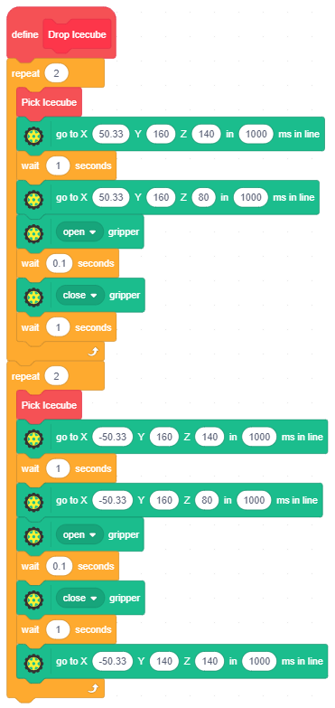

Step 14: Working of the Robotic Arm As Bartender

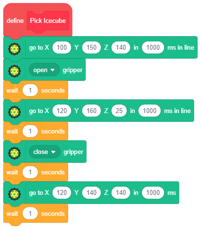

The arm will first pick the ice cube from the bowl, reach the coordinates of the first glass drop it. Again travels back to pick up the second ice cube, and again drops it into the first glass. Now, the entire process will be repeated for the other glass. You can change the number of ice cubes that the robotic arm will drop in each glass.

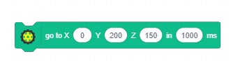

We first need to find out the X, Y, Z coordinates of the places where you want to place the glasses and ice bucket. You can find the coordinates with the help of the go to x (), y (), z () in () ms block.
You can try setting the coordinates in real time or stage mode. But before working in the stage mode upload its firmware by uploading the following code to evive.
Once coded, the robotic arm automatically reached the given place.

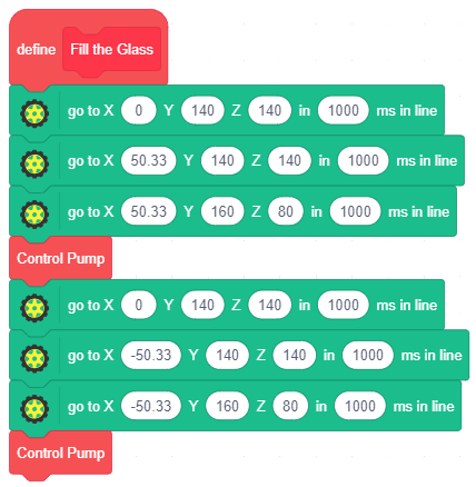

As we know, our robotic arm will even serve the ices in the glasses using the gripper. Thus, we will set the open and close gripper angle for each time the robotic arm reaches the ice bowl or the glasses. We will drop two ice cubes into each glass.

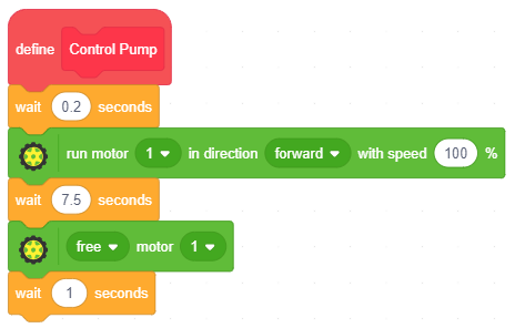

Once, the ice cubes are dropped, it’s time to serve the drink. We have submerged our submersible pump into a big jar filled with drinks. And have placed the pipe onto the robotic arm whose opening can be placed near the gripper. As soon as the ice cubes are dropped, the robotic arm again reaches to glass 1 and start the pump and offs the pump according to the duration set by us in the code. Now, it will fill the glass-2.
To fill the glasses, we need to find out how much time will the pump take to fill one glass. Once you get the time, turn on and off the pump for that duration (EX: In our case, the pump takes 7sec to fill each glass).
Note: you can change the number of ice cubes, glasses, and the duration to keep your pump ON. Thus, this is how our robotic arm will serve the drinks.
Step 15: Graphical Code

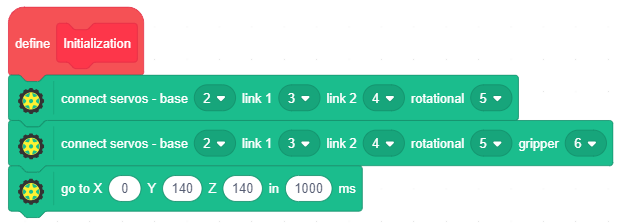

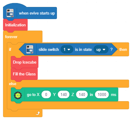

We can either write the code in PictoBlox, the graphical programming language or in Arduino.
The main block will initialize the entire process.
This block initializes all the servos.
This block drops the picked ice cubes into the glasses.
The block below is actually the one that lifts up the ice cube from the bowl.
This block helps the robotic arm travel from glass-2 to glass-1 and back to glass-2 and calls the function to control the submersible pump.
The block below is used to ON and OFF the submersible pump which will pour the liquid into the glasses.
