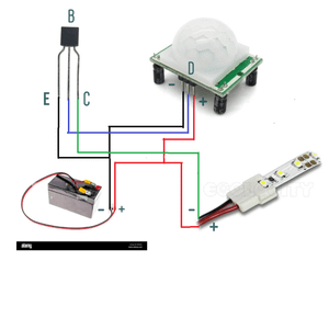

Step 6: Circuit Diagram
Circuit diagram of PIR motion sensor and led strip
The above figure is the circuit diagram of Automatic Room Light Controller. It has very simple circuit which contian PIR Motion Sensor, Transistor, Led strip and power supply.
Step 7: Working Principle
We are using 12 Volt power supply and led strip of same 12 Volt rating. We know that, If we directly connect our led strip to 12 volt power supply, the led will glow. But the objectives of this project is to glow the led only when the sensor detects the motion. If we measure the voltage across the data pin of PIR sensor, we get 0 volt when no motion is detected and 3.3 volt when motion is detected.
We have use BC547 transistor as a switch. If the voltage at base cross the threshold limit (ie 0.4 volt) it triggers the base emitter junction of the transistor. We have connected data pin of the PIR sensor to base of the transistor.
The positive terminal of LED strip is directly connected to +12 volt and negative terminal of the led strip gets the ground only when base of the transistor is triggered. When the motion is detected, there is 3.3 volt across the data pin of the sensor which is enough to trigger the base emitter junction of the transistor. The led strip gets the ground and it glows.
When the motion is not detected, there us 0 volt across the data pin of the sensor which cannot triggers the transistor. The led strip cannot get the ground and it does not glow
