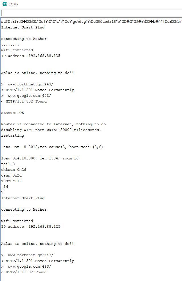

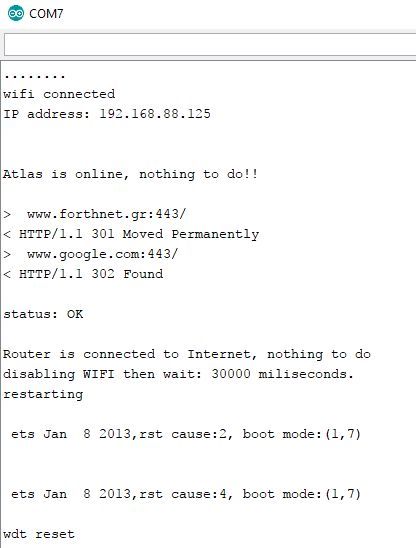

You just have to connect the nodemcu to your computer select board NodeMCU (my version is 1.0 i think) and then upload the code.
If you want, you can study and debug it from the serial communications port.

Led are programmed to display signals every 15 minutes or so but you can change the behavior in the parameters.h file.
Red is power ON.
Green displays OK (2 pulses for Internet and 4 pulses for Server).
Yellow displays not OK (2 pulses for Internet and 4 pulses for Server).
