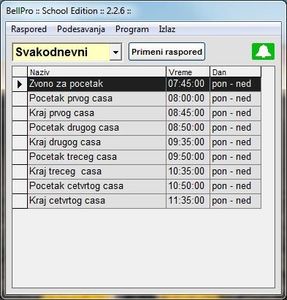

Some features:
  1. Unlimited number of schedules with defined times
  2. Bell rings through the school's PA system

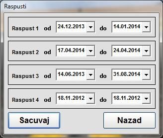

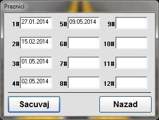

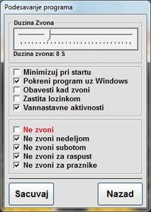

  3. Does not ring on weekends, during holidays, or breaks
  4. Schedule for extracurricular activities (useful for times in sports halls)

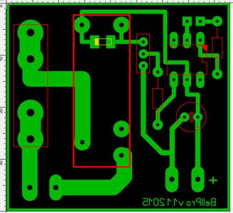

On the link, you will find the complete VB6 source code, the install script, PCB interface schematics, and a KeyGenerator for the pre-built version.

Step 3: Hardware Interface Setup (USB to RS232 Cheap TTL Converter Interface)
All hardware drawings and code are included in the root folder Interface RS232 or USB (draft) folders. The new code for the custom command relay interface is in the delivery phase.
Currently software is set up to:
  1. (triggered via RTS (7 pin) port, interface presence detected via DTR (4 pin))
The interface works best with a native serial port on the motherboard; using USB converters may cause issues if they are not of good quality. Digitus has proven to be a good choice, based on FT232RNL. Also, after restarting the computer where the software is installed, the bell might ring due to signals initializing on the RS232.
