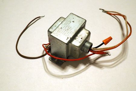

All that is needed is a low-voltage transformer, a contactor (relay), and a box to mount the contactor in.
The photo above shows a class 2 transformer from my junk box. You need is a transformer that has the same input votage as your lighting, and an output voltage of 24 Volts AC. Get a transformer rated for at least 40VA. A good example of a new transformer is the Functional Devices Inc model TR40VA015, it can be used for several input voltages. You can find them at Zoro.com or Grainger for just over $10.

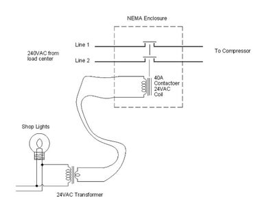

Step 2: Planning the Circuit
The circuit is shown in the schematic. If your transformer is designed for NPT Hub mounting, you can mount it directly to your lighting fixture. Wire the primary side to the lighting power. Read the instructions that come with the transformer to make sure it is correctly wired and set for the correct input voltage.
The connection from the 24VAC side of the transformer to the contactor can be done with 18ga doorbell or thermostat wire. Nothing fancy here.

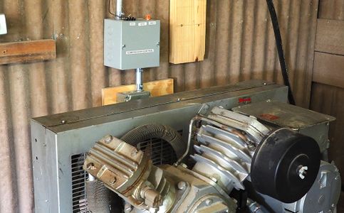

The 240VAC output side of the contactor can be wire one of two ways. If your compressor has a plug, install an appropriate outlet box just below the contactor box. My compressor uses a 30A twist-lock plug, so it was fairly simple. If your compressor is direct wire (no plug), you need to have a disconnect switch either in front or after the contactor. In front (on the main panel side) would be best. If you don't already have a disconnect, an inexpensive disconnect for air conditioning compressors is a good choice. You can get them at the home centers.

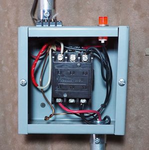

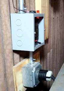

Step 3: Building the Contactor

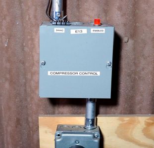

The photos should help. I used a small terminal strip to connect the low voltage wires. It made installation easier. My compressor is on a 240VAC 30A circuit. The 10ga feed from the main panel comes into the top of the box and connects directly to the contactor. Below the contactor enclosure, is an outlet box with the outlet wired to the bottom contacts on the contactor. You may notice my contactor is a three pole device. I only needed two poles for my circuit. There is also a pilot lamp on the box. It is wired to the output of the contactor. My circuit is 240VAC, but my neon pilot lamp was only rated for 120VAC. So to overcome this problem, I wired a 330 Kohm 1/2 watt resistor in series with the lamp. The pilot lamp is not necessary, but I thought it would be a nice touch.

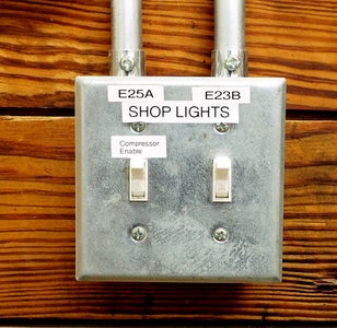

Make sure you label which shop light switch controls the compressor. Turning on this bank of lights energizes the contactor and allows the compressor to run. Turning off the shop lights insures the compressor will not run.
