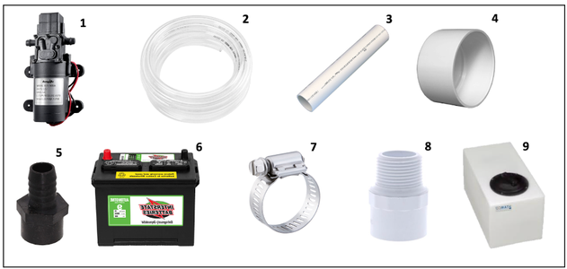

  1. Water pump (12V DC water pump 4.5 L/ min 1.2 GPM 80 psi) x1
  2. Clean vinyl tubing ¾” 20”
  3. 14” PVC pipe with 1” diameter
  4. PVC pipe end cap x1
  5. ¾” to 1” female swivel insert x1
  6. 12V battery x1
  7. Hose clamps x3
  8. 1” PVC MPT x Slip Adaptor x1
  9. 5 gallon water tank

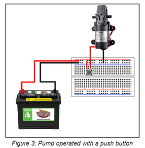

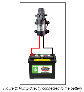

The wiring for the pump is very simple because it works on 12V. When the pump is connected to a 12V battery it will immediately start the flow. The pump can be controlled with a push button or a switch if it was connected to a breadboard.
In Figure 2 we can see the connection where the pump is directly connected to the battery.
In Figure 3 we can see how the battery can be connected to a breadboard and from that we can add a pushbutton to operate the pump. When the push button is pressed the pump will turn on and will stay on until the user stops pressing the button.

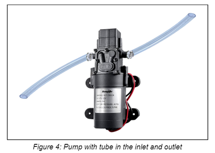

For the pump connection, you are going to use the 20” vinyl tubing and cut it in half so that you have 2 of 10” of the tube. Next, connect the tube to each end of the water pump and use a hose clamp on each end to make sure the tube is tight.

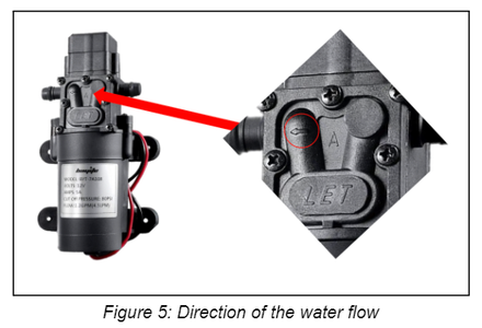

Something that is important about the pump is knowing which is the inlet and the outlet, if you look closely there is an arrow that shows the direction that the water will flow.
In Figure 5, you need to know that the arrow in the red circle is the direction that the water will flow at. This will help you know which is the inlet and the outlet which is needed for the connection to the PVC pipe and the water tank.

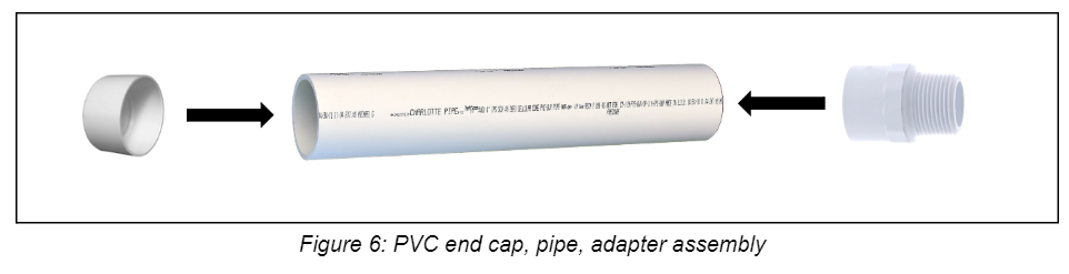

Step 3: PVC Pipe Assembly
This step begins by inserting the PVC end-cap onto one end of the PVC pipe, followed by placing the PVC adapter onto the other end of the PVC pipe. This can be done by gently pushing each piece onto the PVC pipe so that everything is connected as one. This can also be shown in Figure 6.

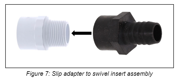

Step 4: Slip Adapter to Swivel Insert Assembly
This step is to place the female swivel insert onto the slip adaptor. The female end threads onto the male end until fastened together tightly. This can be seen in Figure 7.

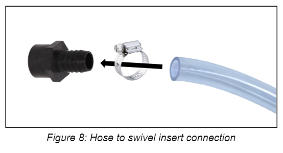

Step 5: Hose to Swivel Insert Connection
This step is to connect the vinyl tubing to the female swivel insert and fastening the two together using a hose clamp. The hose can be slid over the insert until it reaches the base, where the hose clamp can be tightened around to ensure a strong connection. This can be seen in Figure 8.
