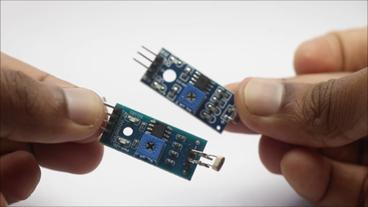

I will talk few things about the project that i have built, The solar tracker that i have made consists of LDR modules, that stands for light dependent resistor.
This resistors are sensitive to light and change their resistance when exposed to light i will use this to trigger the servo on 2 sides to which we are adding the solar panel that will trap the energy of the sun all the day.

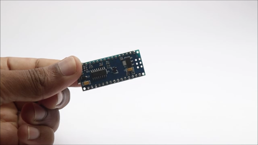

I will power this project with arduino nano that is very small and also uses very less power and occupies less space compared to other such alternatives.

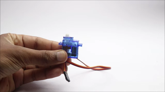

Micro Servo

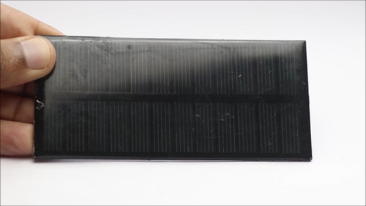

Solar Panel

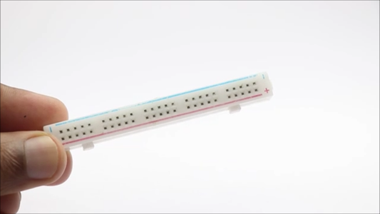

Breadboard Power Rails

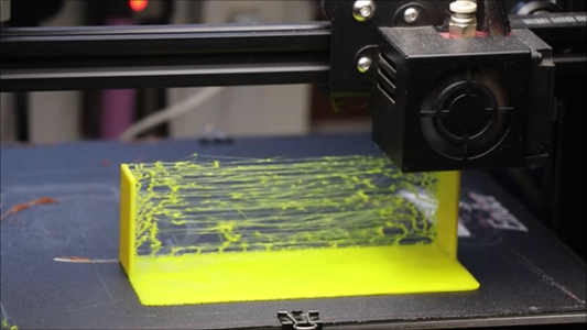

I have designed the frame for this project using Tinkercad if you wish to modify model you can do it as per your requirements.
Once i designed the model considering the size of solar panel that i will be using, I will use cura slicer to slice the model.

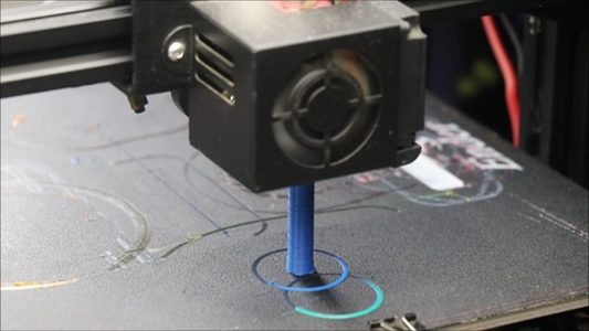

I will slice the model and later print it with PLA filament, the settings that i will be using to print the 2 models is shown in the cura slicer settings.
There is no need of any rafts or supports to be used at the time of slicing, Also there is no need of any post processing after the print is done.
The choice of color at the time of printing is left to you, in my case i used yellow color for the frame and the blue color to the cylinder that is connected to the horns of micro servo.
The printing will not take much longer since the parts are optimised to print faster also consuming less print material.

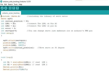

I will ask everyone to upload the code first before building the circuit, Connect the USB board to computer and arduino and open Arduino ide.
Copy and paste the below code to your IDE and select the proper board type(arduino nano) and the port to which your board is connected.
Note that the port number changes be sure to select the arduino nano.
Upload the code to nano and disconnect the USB cable, Now we can head over to building the circuit by following the circuit diagram.

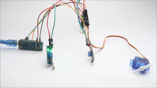

The circuit is really simple we are using servo and LDR module
Servo has 3 pins, Vcc, Gnd and signal
I will connect the vcc and gnd to power rails on breadboard whereas the signal is connected to D4 pin on the nano board.
The 2 LDR module vcc and gnd will go to the power rails of the breadboard whereas the signal of this 2 modules are connect to A0 and A1 pin on the nano.
Now in the end connect the 5v and gnd pin from nano to power rails on the breadboard.
Test the circuit by connecting the nano board to power supply, When you expose the LDR to light the indicator led should blink if it is not you should turn the knob of potentiometer to alter the sensitivity of the sensor.

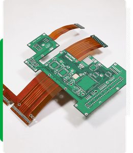

You also can replace this open circuit with a Simple small PCB with speed controller, Complete your electronic projects in the best way from PCBWay
Why them? They have provided me with the best PCB and The quality is just amazing compared to other providers in the market, They also have Color PCB printing check it out
Check Here for their Multicolor 3D printing service with this your project becomes more interesting

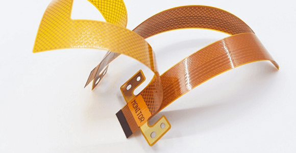

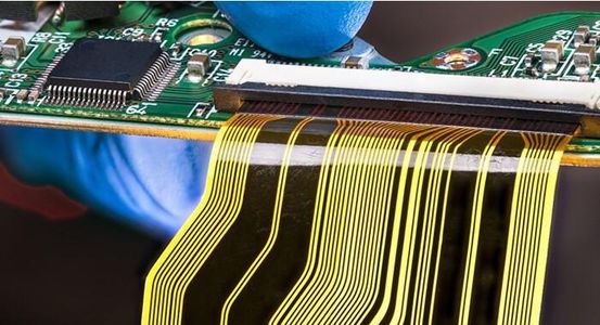

A revolutionary solution that combines the best of both rigid and flexible circuitry to elevate your electronic projects to new heights.
Don't miss to check their assembly offer here , For a Limited time only 29$ for 20pcs
PCBA & Online quote available with 24h delivery services
Their expertise in advanced manufacturing techniques offers a seamless integration of rigid and flexible components, ensuring enhanced reliability, durability, and space-saving benefits.

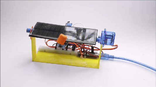

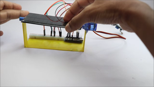

To set all the electronics on the 3d printed frame all you have to do is use the double sided adhesive or hot glue for coupling.
I just used the power rails of the breadboard to shrink the size of the circuit, You can even more shrink the circuit using the wires.

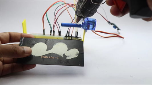

Now connect the servo horn to the 3d printed tube and this part do not require any glue to establish the connection.
Later pour some hot glue to the frame and place the servo on this and allow to dry for some time, After it is dry we can connect the solar panel to this prolonged shaft.
The solar panel other end should be supported on top of the frame so that when the servo shaft rotates it will also rotate the panel.
Step 4: How It Works

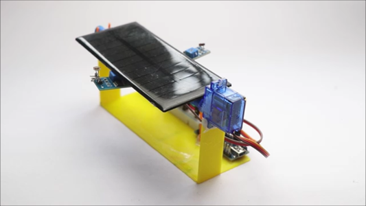

This works automatically all you have to do is connect the board to USB source and keep it in front of the sunlight.
I have left the servo horn slider part open so that you can add any size solar panel equal or lesser than the size of the frame of the tracker.
To test the circuit place this tracker on the dark and turn on the flashlight, the solar panel will move to the direction of the light.
To utilize the light generated from the solar panel after installing on this solar tracker connect a multimeter and test ṭhe power output, you can expect steady output throughout the daytime.
