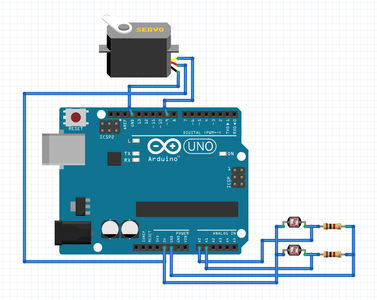

As the circuit is using a Arduino Uno you can connect all the components to the Arduino using jumper wires. You need to connect the signal wire of the servo motor to pin 9 and then connect the two LDRs to A0 and A1. I have included the wiring diagram.

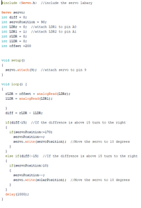

Once all the components are connected together you will need to upload the code to the Arduino. To do this connect the Arduino to the computer using a USB cable and open the Arduino IDE. Copy in my code and upload it to the Arduino.
