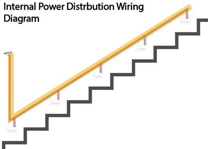

The main idea behind this project is that I want to control each light separately. each light act according to my foot position and remains active during the nighttime.

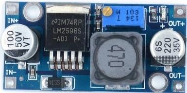

| 1x LM2596 Dc-Dc Buck Converter | |

Step 2: Light Assembly
HCSR04 sensor is used in a single-wire mode which means a single wire for both echo and trigger.
- First, extend 3 sensor wires (+5V, Signal, GND) as shown above. Here I use masking tape to protect the sensor during soldering
- Cut out two LED strips and place them over the 3d printed LED base.
- For sensor, placement cut out two circles on the top of the footlight. so that sensor is placed inside the LED light.
- Solder out +12V, GND wire of LED strip to footlight.
- Place sensor and 3d printed eye to the LED light.
The single LED light is ready, now 4 lights are remaining.

| LM2596 Dc-Dc Buck Converter Output | Arduino+LDR+US |
| +5 V => | (+5V LDR),(+5V U.S),(+5V Arduino) |
