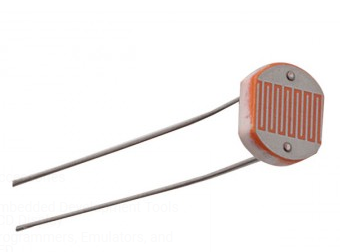

Step 1: Photoresistor or Light Dependent Resistor LDR
A photoresistor or light dependent resistor LDR is a component that is sensitive to light. When light falls upon it then the resistance changes.
Values of resistance of an LDR or photoresistor change to several Megaohms(MΩ) in darkness and then fall to a few hundred ohms in bright light. With such a wide variation in resistance, LDRs are easy to use in many application circuits. Here we will be using LDR to automatically control the demo Street Lights.
