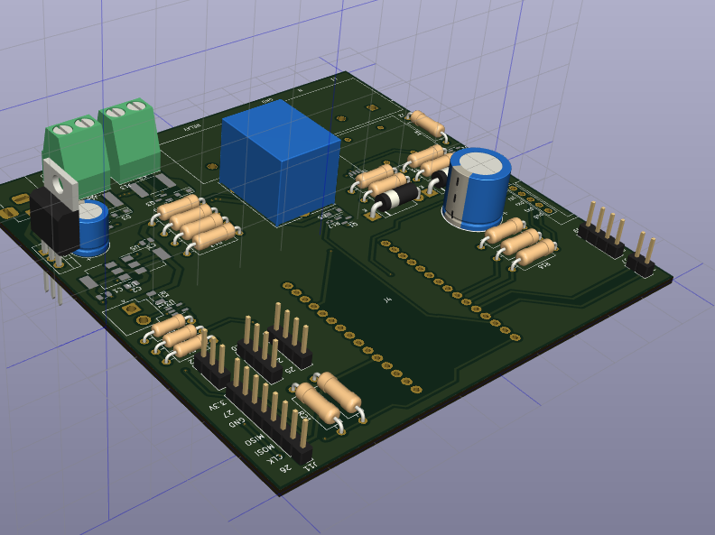

PCB View
3D View
PCB With Assembly

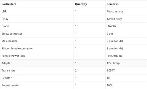

Bill Of Materails
BOM_automatic-street-light-controller_2023-05-29Download
