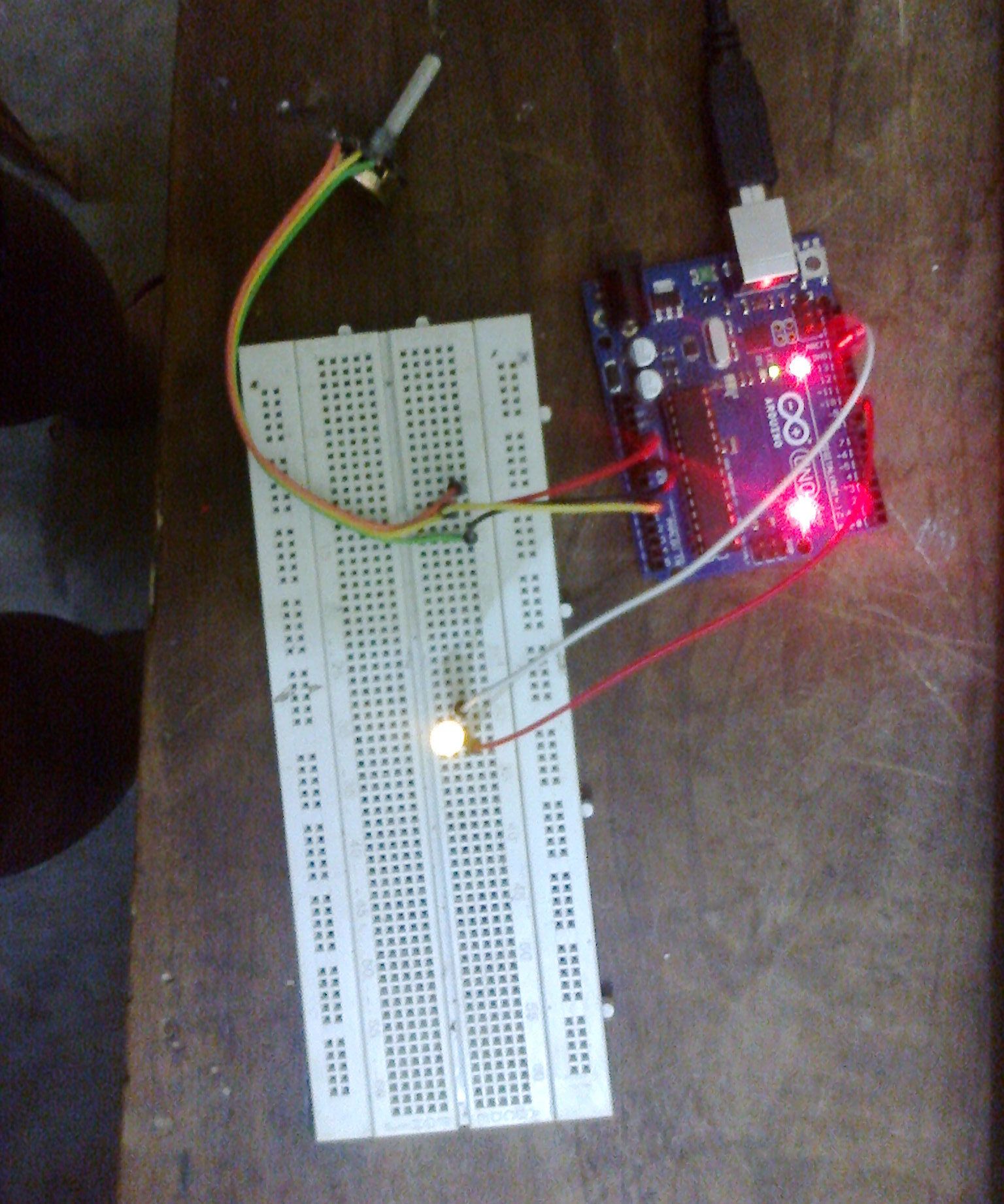

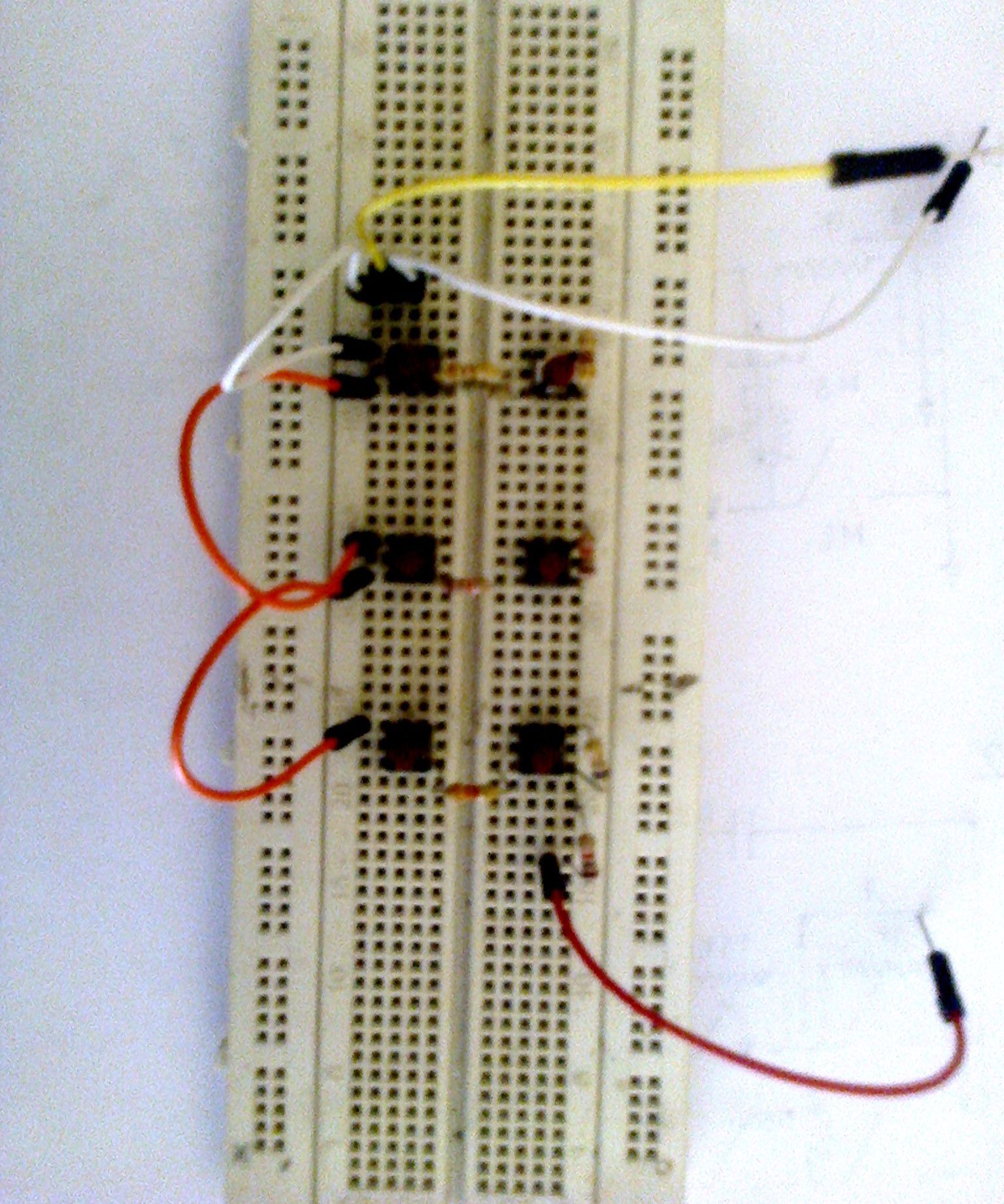

Step 2: INTERFACING PROXIMITY SENSOR
1. Proximity Sensor :
A proximity sensor is a sensor able to detect the presence of nearby objects without any physical contact.
A proximity sensor often emits an electromagnetic field or a beam of electromagnetic radiation(infrared, for instance), and looks for changes in the field or return signal. The object being sensed is often referred to as the proximity sensor's target. Different proximity sensor targets demand different sensors. For example, a capacitive or photoelectric sensor might be suitable for a plastic target; an inductive proximity sensor always requires a metal target.
The proximity sensor module contains a IR LED and a photo transistor whose output is given to an operational amplifier IC like LM358 for proper amplification.
The diagram above shows interfacing of a proximity sensor the V pin is connected to the 5V and the GND pin is connected to corresponding GND of the Arduino. The blue box with the screw is used for the sensitivity adjustments. The OUT is connected to the analog input of Arduino.
Two proximity sensors are mounted just below the handle of the door so that when a person opens the door using the handle the proximity sensor shows a change in its output level . The front side of the proximity sensor acts as a positive counter and the one in the back side acts as a negative counter which counts how many person have entered and left .
