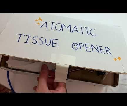

This product imitated the function of "Automatic Tissue Opener" from claire833.sung (https://www.instructables.com/Automatic-Box-Opener. ) The tissue case can prevent dust and germs from contacting to tissue. Due to the pandemic, people care more about sanitation and want to lower the risk of touching public appliances. The Automatic Tissue Opener can solve people's problem!!!

Step 1: Connect the Materials With the Arduino Leonardo and Breadboard
Step 2: Code

Step 3: Make the Box
