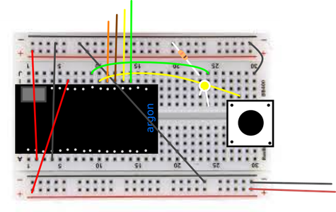

Arrange your Argon, wires, button, LED, stepper motor, and motor controller according to the diagram above. The colors of the wire do not matter, but having different colors will help you not get confused about what goes into what spot.
Step 3: Flash Code to the Argon
