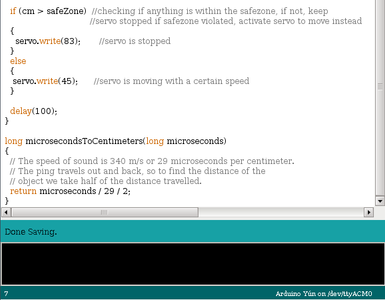

Step 7: Arduino Code - Test It
The arduino code is controlling the servo to move every time the sensor senses an object closer than 5 cm.That means that as long as we keep our hands closer than 5cm to the sensor the paper will unfold.
I found the code from here Tree house projects and i made the adjustments, because i use a servo and not leds.
Upload the code from the arduino IDE to your arduino and you are ready to test it.
