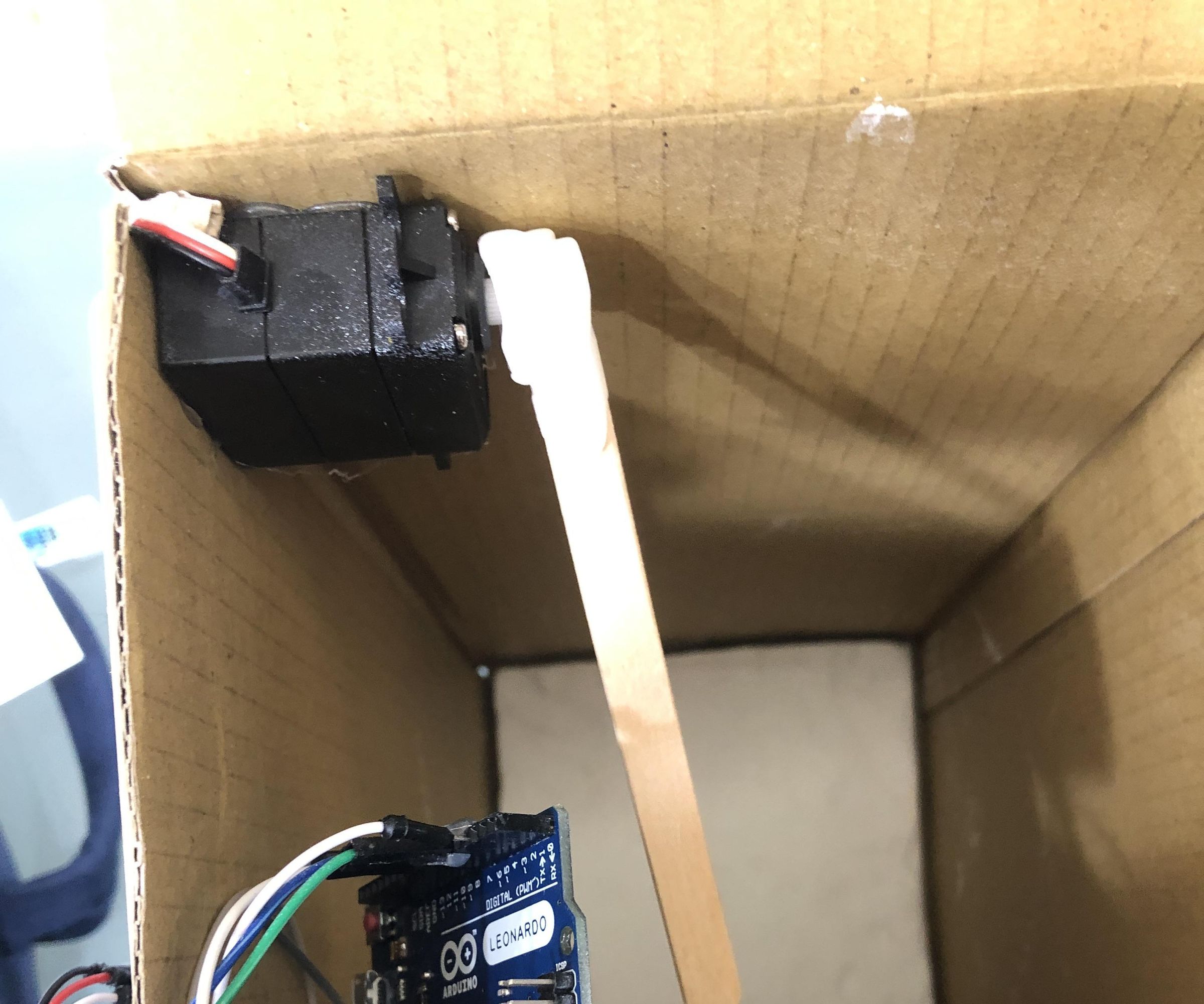

Step 2: Connect to Servo Arm
Just take this servo arm and connect it to a long card board piece with hot glue or other glues. You can also use Ice Cream stick instead of Card Board. Then connect the long servo arm to servo motor.Use thermoplastic to stick the wood stick on the servo.
