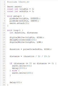

Step 3: Code
This is the code and I am going to explain how it works.
1.Include Servo Library (line 1)
What this basically does is it controls the servo motor so its basically the servo library
2.Declaring Variables and Pin Numbers (lines 3, 4 and 5)
  • servo: this allows the servo to rotate from 0 to 180
  • trig Pin: this is a digital pin of the trig pin from the ultrasonic distance sensor
  • echo Pin: this is a digital pin of the echo pin from the ultrasonic distance sensor
3.Setup Function (lines 7, 8, 9 and 10)
  • Makes the trig Pin into an output and the echo Pin into an input
  • Attaches the servo motor to pin 3 (change it if you are using a different pin)
4.Loop Function (lines 13-35)
  • Sends a pulse to the trig pin to startup the ultrasonic distance sensor
  • Measures the duration of the pulse on the echo pin
  • Calculates the distance based on the duration of the pulse
  • If the distance is within range which is 50 it moves the servo to 50 degrees otherwise is moves the servo to position 160 degrees
  • adds a short delay before the loop starts again
